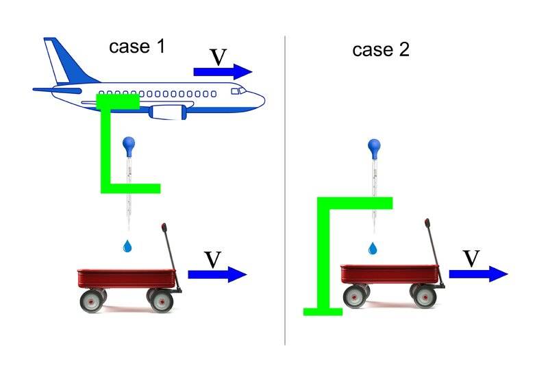

How to use Newton's second law to treat differently the two cases below in which a system has its mass increased?
Hi All,
in the figure below we see two cases in which a wheelbarrow moves with speed v, containing a certain mass of water. At a given time t0 a drop of water is added to the system by a dripper. In case 1, the drop enters the system, which increases in mass, having the same speed as the cart. In case 2 the drop is at rest relative to the ground on which the cart moves. Considering Newton's second law expressed in terms of the derivative of linear momentum, how do we treat each case to understand the respective consequences of the increase in mass?
Obs.: consider possible existence of an external and constant force acting on this system.
Best wishes

Hi Perok, I have just assembled these figures (plane, dripper, etc) to mount the exercise. I have a general doubt concerning the way mass enters or leaves a system. It seems that elements of mass can enter a system with some initial velocity, for instance. My question has to do with this. How do we manipulate the formalism to make it manifest the entrance of mass with or without some given initial velocity. Specifically the formalism implied by the second law, with the derivative of the linear momentum included.

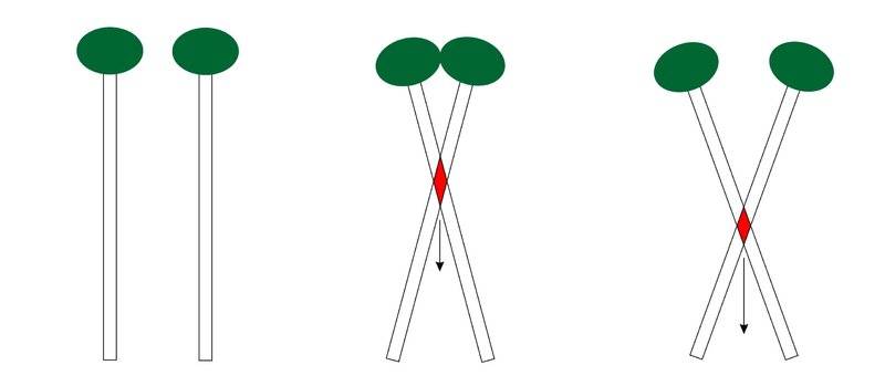

This example of PeroK reminds me a bit of a notion related to the Einstein's relativity. If two very tall trees fall as in the figure below, their interception can eventually travel faster than light, which does not violate Einstein's postulates.
DaTario said:
Why is it not correct to tell students that ##\vec F_{ext} = \frac{d}{dt}\vec p ## ?
In principle you can call any term with the right dimensions a 'force' (see inertial forces), but conceptually there is difference to forces that for example can cause deformation.

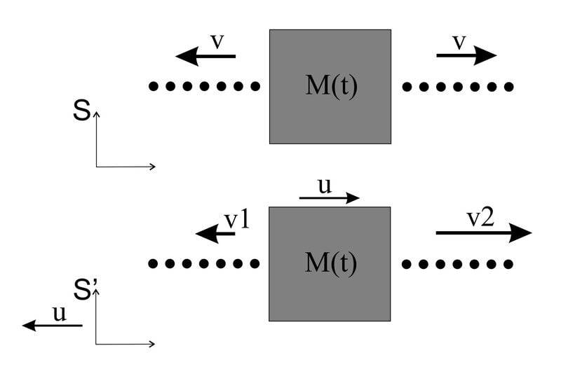

Note that the ##v##, being the instantaneous velocity of the changing mass, is a frame dependent quantity. Hence force becomes frame dependent.
One important point about ##F= ma## is that it is independent of the choice of inertial reference frame.
