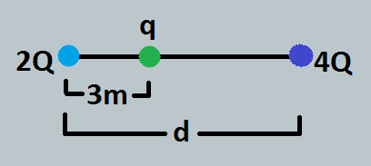

A charge 2Q is placed a distance 'd' from charge 4Q. A third charge 'q' is placed 3m from charge 2Q directly on the line between charges 2Q and 4Q. Find d and q such that the force between charges 2Q and 4Q is equal to 0.
Coulomb's law: f = k(|q1q2|)/r2
k = 8.99 x 10^9 (Nm^2/c^2)
(k)(2Q)(q)/3 = [k(4Q)(q)]/(d - 3)
(d - 3)/3 = 2
d - 3 = 6;
d = 9m?k(2Q)(q)/3 + [k(4Q)(q)]/6 = k(2Q)(4Q)/9;
q[(k4Q)/6 + (k4Q)/6] = k8Q2/9;
q[k4Q/3] = k8Q2/9;
q = (3)(2Q)/9 ?
q = 2Q/3 ?

I'm not sure I understand the question, and I certainly do not understand the attempted solution.
What is meant by "the force between charges 2Q and 4Q"? The obvious meaning is the force they exert on each other, but that would be unaffected by q. You seem to have interpreted it as the net force exerted on q, but it cannot be that since you would have no way to determine q.
How do you arrive at the equation here:
Color_of_Cyan said:
(k)(2Q)(q)/32+ (k)(4Q)(q)/(7.2426 - 3)2= (k)(2Q)(4Q)/(7.2426)2
You have the two forces exerted by 2Q and 4Q on q adding instead of opposing, and why should they add to the force 2Q and 4Q exert on each other?
A possible interpretation is that there should be no net force on either 2Q or 4Q. That would give you two equations with two unknowns. But if that is what the question means the wording is very poor.

No, you misunderstand.
As you agreed, the condition is that the net force on each of 2Q and 4Q (separately) is zero.
So just consider the net force on one at a time. Don't try to combine them into one equation.
ahhh okay
so for 2Q I get this: k(2Q)(q)/32 + k(4Q)(2Q)/d2 = 0
and for 4Q I get this: k(2Q)(4Q)/d2 + k(q)(4Q)/(d - 3)2 = 0

This is no different from what you were doing earlier in the beginning of this thread where you got d=7.2426m. For cancellation of the forces,
i) Force on 2Q by q=Force on 2Q by 4Q
ii) Force on 4Q by q= force on 4Q by 2Q.
(with directions opposite to each other of course, since q is negative.)
Out of these, the right hand sides are equal, giving force on 2Q by q= force on 4Q by q. This is the equation you'd been working on in the beginning.
Quite an epic story about d. In reality, everything is not so grave)
Once, you get to the point
$$(d-3)^2=18$$
It means that
$$d-3 =\pm 3 \sqrt{2}$$
$$d =3(1 \pm \sqrt{2})$$
Certainly, you choose the positive answer for the distance (in meters)
$$d = 3 (1+ \sqrt{2})$$
Seems, that
$$|q|=\left ( \frac{2}{1+\sqrt{2}} \right )^2|Q|$$
Guess the sign?
