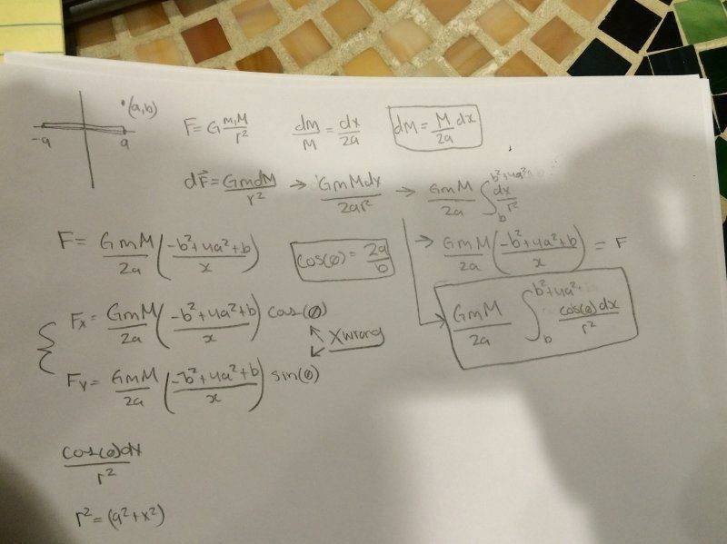

Considering what you said, do you mind determining if my analysis of this problem is correct? A thin rod of length 2a has uniform density. The rod is centered at the origin along the x axis. Write an integral expression for the x and y components of the gravitational field at the point (x, y, 0). I can't seem to able to related cos(theta)dx/r^2 where I boxed it in on my paper. Look at top left for a picture.
  • Handwritten derivation on paper of gravitational force from a thin rod of length 2a, with a small sketch of the rod on the x axis and point (a, b), showing dF, dM = M dx / 2a, and a boxed integral of cos(theta) dx over r^2.

In the problem from the attached post, you are trying to determine the effect of gravity on the rod, I think, w.r.t. the point (a,b), but it's not entirely clear from your description.
