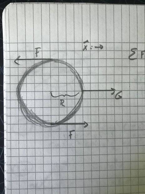

Hi! I made a problem myself inspired by a typical mechanics problem, where you have two equal forces acting on each end of a wheel/disc and a third one that is suppose to stop the wheel/dic from rotating. So let me get into the details,
Let's say, we have a bicycle that is upside-down and you start to rotate the frontwheel with two equal forces on the distance R from the center of the wheel on opposite sides of the wheel (the wheel is also fixated to its center). It starts to rotate and the net-force is equal to zero (if we set the positive direction to one of the forces direction and the negative direction to the other force), whilst the torque is FR + FR = 2FR.
Now, we add a third force which is located on the arc of the wheel between the two equal forces, and call it G. The force, G, makes a 180 degree angle between itself and the radius of the wheel, and the force points away from the wheel (similar to if you had a rope attached to the arc of the wheel and you pull it to stop the wheel). Now comes the part where I'm stuck,
The net-force is now, F + G - F = 0 => G = 0 (?)
The torque is, FR + FR - G x R = 0 => lim v->180, 2F/(sin(v)) = G = infinity (?)
I know there's a detail I've missed but I really can't see it. Can any of you?
Also, ignore friction and other typical forces that can stop the wheel on its own
Your analysis looks correct. The force ##\vec G## must be zero if the wheel is not to move and, since it is radial it cannot affect the angular momentum of the wheel.
I suspect you do not intend the force ##\vec G## to be radial. That is certainly not how a rope attached to the wheel would behave; it would be always horizontal (or that would be good enough for a first attempt anyway).
Also, you need a fourth force to stop the bicycle accelerating. This would normally be friction from the ground transmitted to the wheel through the forks, so would counter the acceleration of ##\vec G## without affecting its torque.

The missing detail is the Free Body Diagram.
The direction of G is confused.

Per the problem description you have four forces.
Alright, that is missleading. I tried to say "the wheel/disc rotates around it's center" but I wanted it to be clear that the body can't leave its place. It (can) spin freely (in the air or around its axis) but the force G stops it from spinning.
Yes, so it needs a fourth force through its axis pointing to the left in order to stop it from moving.

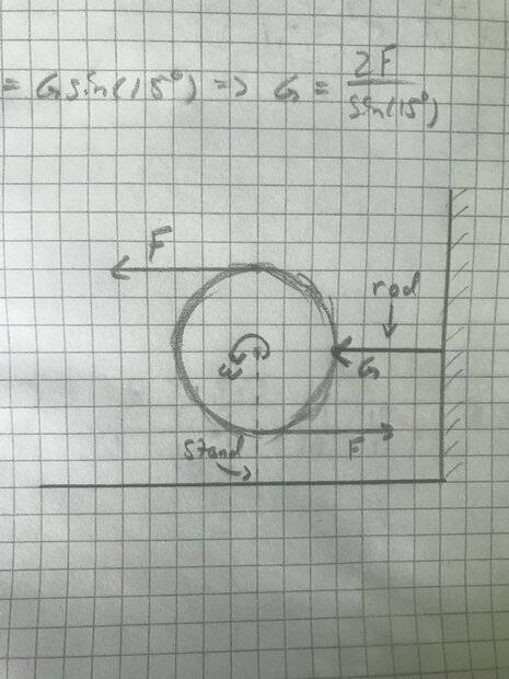

You also need to think about how ##\vec G## is applied. If it's a rope attached to a point on the rim of the wheel, what will your diagram look like a moment later when the rope attachment point is (e.g.) 15° above where it's currently shown?
The force G becomes; G = 2F/sin(180-15), which is a very big force
So you are assuming that the force G is always applied horizontally. Fine.
But the point is that as the wheel rotates, the plce where the rope is attached moves with the wheel. So the force needed to counteract the torque of the two Fs varies with time. It is infinite in your initial situation, but it is finite at other instants.
Here's a free body diagram of the problem.
The wheel will rotate until it is stopped by the force G being applied to a fixed point on the wheel, in a direction other than radial.
You must redraw the FBD with the G at some other angle.
You're saying the only case where the force G (which is always horizontal) can be finite is when the force [G] is at instances where the angle between G and the radius is non-zero/non-180-degree? Mathematically, I get it, but if I would do the experiment at home, I wouldn't need an infinite big force to stop the wheel from spinning.

I can do a variant of the problem,
We have the wheel spinning when the two forces F is applied to the wheel (shown in figure). Now we have a rod that is attached to the right wall and stops the wheel from spinning. Due to Newton's third law, the force G that the rod applies to the wheel should equal a horizontal "force-rope" as previously discussed. There's no friction between the rod and the wheel, so it goes for the center of the wheel and the stand (dashed line).
In this scenario, the rod has to stop the centripetal force that the two F's contribute to. Then we get,
G = 2mw^(2)*R (where m is the mass of the wheel)
G in this case is not zero, and the angle between the rod and the radius is constant (180 degrees). So shouldn't this principle also apply to the case when there's a rope attached to the rim and pulling the wheel in a horizontal direction (and the placement is the same as previously discussed)?
... a rod that is attached to the right wall and stops the wheel from spinning. ....There's no friction between the rod and the wheel...
If there is no friction, how would the rod stop the wheel from spinning?

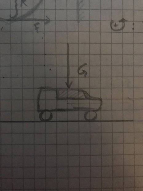

If you only apply a radial force it can never slow the disc. It's like pressing down on a toy car: all you do is squash it, it doesn't start to accelerate horizontally. Similarly a radial force will never change tangential speed.
If you apply the force at the top of the wheel you will only need ##2F## to hold the acceleration to zero. You will need more at other angles because you are "wasting" some of your force trying to distort the wheel.

So what you described is the same as what I drew in the following figure? If so then I totally understand that the force ##G## can't contribute to any movement, as long as ##G## is perpendicular to the roof of the car.
(I know there should be two normal forces acting from the ground that adds up to a net force equal to ##G##).
