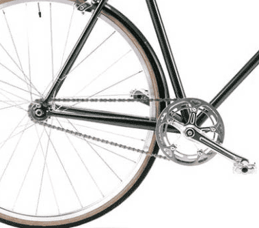

Yes it is similar drive chain, however I was under the impression that if I want to provide high torque to my driven wheel, then my driver wheel would be larger than the driven?
No , its other way ie if you need high torque at driven wheel make it larger than the drive wheel

My driven wheel/sprocket has the actual bicycle wheel attached to it, therefore I want to provide high torque to this... In the same way that a single speed bike works, I want to provide high torque to the rear wheel therefore my driver wheel should be bigger? See pic for below for reference
See how the driver wheel is larger to provide high torque to the actual bike wheel.
The small sprocket is to increase the speed and not torque, what you want is high torque, so you fix a bigger sprocket at driven wheel and smaller sprocket at drive end.
