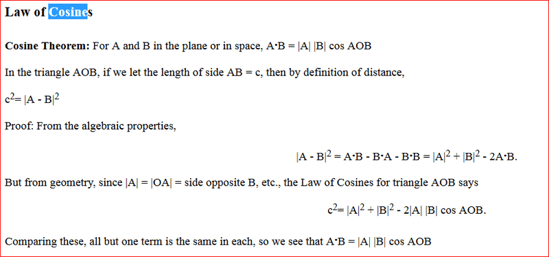

but does the cosine law of vectors have an impact on the expression?
https://www.math.washington.edu/~king/coursedir/m445w04/notes/vector/dotproduct.html
also this link, scroll downwards
https://en.m.wikipedia.org/wiki/Law_of_cosines
but you all say the expression I.VcosØ is correct and technically same (from electricity viewpoint) as v.icos∅, then I must accept it.
i guess i don't understand the question.
Trigonometry applies to all triangles, be they phasors or vectors or real geometric shapes like land surveys.Much of learning is just coming to believe what you already know. One reassures himself by working out with pencil and paper enough examples that the steps become automatic.
