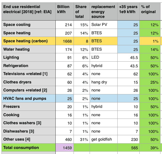

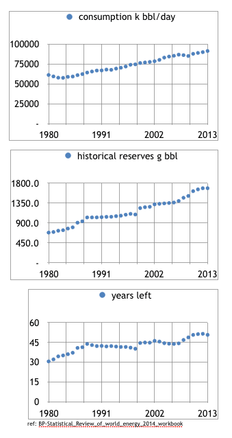

Given that:
When will fossil fuel reserves be diminished?
"The new formula is modified from the Klass model and thus assumes a continuous compound rate and computes fossil fuel reserve depletion times for oil, coal and gas of approximately 35, 107 and 37 years, respectively."
[bolding mine]​
36 years is within my "End of Life" scenario!
So, say, right now, all new/sold homes have to have an installed thermal storage system, ala Drake Landing, and a 3 kw solar grid tied PV system. [I estimate the cost to be about $20,000 per home. Or about 10% of the values of the homes.]
What are problems with this scenario?
Aside from the fact that I can't solve partial differential equations. :oldmad:
And PVC pipe has a 140°F limit. :oldmad:

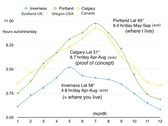

I've been simultaneously working on designs for my sister[latitude 33°, California coast] and myself[latitude 45.5°, 110 km east of the Pacific ocean]
It mostly involves looking at your heating and cooling bills, and determining cloud cover during the day.
But I believe I was most curious, in starting this thread, as to what kind of extra infrastructure would be required to transfer electricity around the nation, to cover cloudy days.

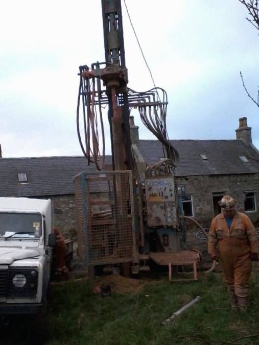

"I had a 6” wide and 100’ deep borehole put in a few years ago. It took a day - would this work with your system?"
@Guineafowl , if you don't mind me asking, how much did that cost you? And what were the conditions? Did they have to drill through granite, or was it just soil?

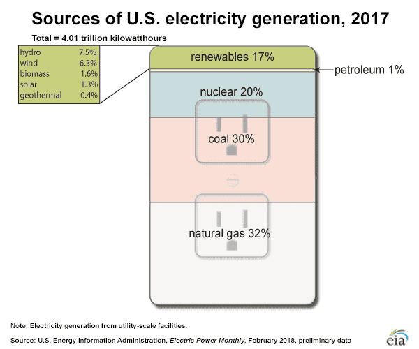

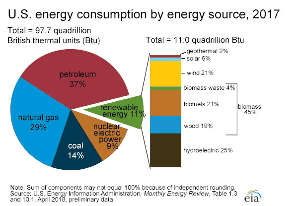

For the record in 2017 this was the energy use distribution in the US .
  • Electric power—38.1%
  • Transportation—28.8%
  • Industrial—22.4%
  • Residential—6.2%
  • Commercial—4.5%
Sources of energy :
241748
241752
We would need to increase other electric sources by 300% to replace fossil fuel electric sources. In general people have no idea of the scope of the problem that faces them in the future if they wait until they have no choice but to do something. There are currently 60 commercial nuclear power plant in the US generating 99 gW of electricity. Nuclear is probably the only acceptable continually running and environmentally clean power source. Can we build 180 nuclear plants in which one currently take about 5 years from ground breaking to energy production. If petroleum products run out in 40 Years can we commission up to one nuc plant a month when we finally realize we have to by 2035 . This only replaces current electricity production and does not include transitioning to an all electric economy. This does not take into consideration any results of global warming. The United Nations climate report from last year noted that to limit the global temperature rise to 1.5 deg C by 2050 we must reduce our fossil fuel consumption 40% by 2030 that is about 4% per year starting last year. Usage continues to increase.

Though I'm sure the numbers are the same, I like the info-graphic put out by the Lawrence Livermore National Laboratory, a bit more:
Sankey diagram of estimated U.S. energy consumption in 2018, 101.2 quads, showing sources (solar, nuclear, hydro, wind, geothermal, natural gas, coal, biomass, petroleum) flowing through electricity generation and end uses (residential, commercial, industrial, transportation) to energy services and rejected energy.
Though, it doesn't list how residential energy use is broken down. For that I had to go to the EIA. I'd prefer to ignore Industrial and Commercial consumption in this thread, as I'm sure they've got lots of resources to figure out their own problems.
As you can imagine, I spent most of yesterday trying to get rid of that 300%.
Ehr mehr gerd...
Here's a picture of what I came up with, utilizing BTES [Borehole Thermal Energy Storage] and PV:
Table of US residential electricity end uses in 2018 in billion kWh, with share of total, replacement energy source, projected +35 year values and percent of original; total consumption 1459 billion kWh falling to 565 (39%).
The yellow "Space heating (carbon)" is my interpolation of the Lawrence Livermore data, and should be ignored, as far as "electrical" replacement goes. I couldn't believe that electrical "cooling" demands exceeded "heating" demands, but that kind of explained it. The "8" in the "Share of total" column is its ratio to electrical heating, and not its share of total.
The blue "25" numbers I pulled from the "HVAC fans and pumps" line. For any reasonably efficient system, there will always be pumping loads.
Anyways, the 39% [bottom right] number covers some of your "300%" number.
The most surprising number is the "Other uses". 31%!
My "get goldfish" comes from a comment I made to Zoobyshoe, when I discovered that my 55 watt fish tank heater accounted for a significant portion of his electrical usage.
"So I plugged my 20 gallon fish tank's power drains into my Kill-A-Watt meter, and discovered that it consumes more than half of your monthly energy: 46 kwh!
I am never again investing in guppies...
[ref]
The borehole was drilled 30m (100ft) deep, sleeved for the first 6m (20ft) with steel pipe and thereafter with perforated plastic. I think the diameter was 150mm (6”).
The rock started out as a sort of layered, soft mudstone which progressed to very hard granite (the poor man broke his expensive drill bit!)
It cost around £3500.
In fact, I have some pics:
The Mog is essentially a huge hammer drill, and the Land Rover towed in a large compressor, to run the hammer and blow out debris from the drill hole.
Blue and white truck-mounted drilling rig with a tall mast, parked on muddy ground beside bare trees; lettering on the cab reads REEBURN and 08700 711177.
Photo of a tall truck-mounted rotary drilling rig on grass in front of a stone farmhouse, with a worker in orange overalls and a hard hat beside it and a white Land Rover at left.

As far as the oil running out number I originally posted, I have no idea if that paper is correct.
BP has the number @ around 50 years.
Three stacked scatter plots of world oil data from 1980 to 2013: consumption in thousand barrels per day, historical reserves in billion barrels, and years left. All three series rise over the period.
But as I mentioned earlier, it's not my problem, as I'll most likely be dead.

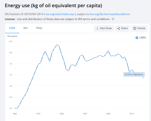

Lately, per capita North American energy consumption has gone down since, per this graph, its peak in 1979:
Line graph titled "Energy use (kg of oil equivalent per capita)" from 1960 to about 2015, showing North America rising from about 5.5 to a peak near 8.3 in the late 1970s, then fluctuating and falling to about 6.9 by 2015. Y-axis labelled in thousands from 5.5 to 8.5.
[ref]
