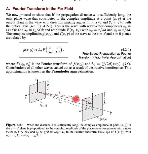

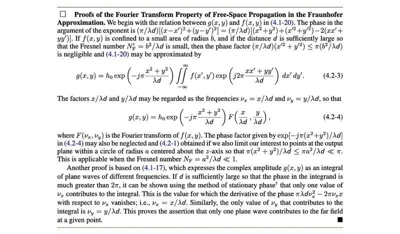

The key of Fourier Optics: Why does a Plane Wave contribute to just a Single Point in the far field? (the plane wave goes through an aperature => actually a superposition of plane waves) I'm afraid my Fourier Optics profs doesn't quite get it either. (source: Fundamentals of Photonics, Saleh/Teich)
If the distance between the input and the output screen d is large enough, then for a plane wave (with some spatial frequencies vx and vy) at the input, the spot at the output will be a point. But if the plane wave is confined (aperature size b in the picture), it's no longer a plane wave... but a sum of plane waves. The proof here mentions the method of stationary phase and a phase factor that goes to zero. Sure, the math works out, but I still don't get intuitively. The only think that makes sense is to treat the plane wave as a gaussian laser beam (and so the dots are also gaussians). But this is not consistent, since a laser beam consists of many plane waves at different angles and here it's clearly mentioned that just one plane wave / spatial frequency contribute to a given point... Thanks a lot for any insight!

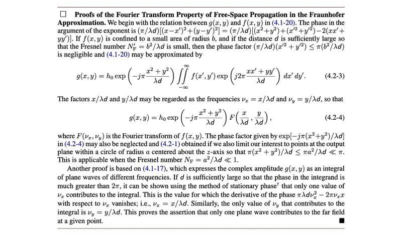

I'm not sure I understand your question. Are there supposed to be images? If so, they didn't attach properly.
Sorry, my bad. Should be fixed now. This is gibberish without images (possibly even with images) The question is: Why do plane waves get transformed into points in the far field?

Daniel Petka said:
Through propagation alone, it makes zero sense why a plane wave should be transformed into a point.
That doesn't appear to be what it says, though. What it says is that the only plane wave that contributes to the complex amplitude at a point is.... Without bothering to read the proof, I expect what it does is show that plane waves exist in pairs with opposite phase shifts, except for one, do they all cancel out except that one.
Note that we're working in the far field here. Plane waves are all we get, just coming from slightly different angles.
