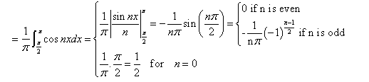

I don't see how if n = 0 then the answer is 1/2. By my reckoning
1/pi * sin nx/n =
1/pi * 0 = 0
I also don't see where the 2 comes from when sin(npi/2) first shows up.

If n=0, you should calculate the integral differently. Also lim x->0 sin(x)/x is not 0, so you get the correct result even if you just do take the limit.

The upper limit substitution is always zero. You get pi/2 from the lower limit.
robertjford80 said:
I'm also having a difficult time converting sin(npi/2) into -1^(n-1)/2. where does the 2 come from in the denominator?
It comes from the fact that then they are equal... Work it out. Plug in values n=1,3,5,... and see how sine behaves, then see what the 2 does in the denominator.

You are trying to find,
[tex]\frac{1}{\pi }\int_{\pi/2}^{\pi} cos(nx) dx[/tex]
At n=0,
[tex]\frac{1}{\pi }\int_{\pi/2}^{\pi} cos(0)dx = \frac{1}{\pi }\int_{\pi/2}^{\pi}1\cdot dx[/tex]
What do you get if you integrate this??
For [itex]n=0[/itex] you have
[itex]\dfrac{1}{\pi}\displaystyle\int\limits_{\frac{\pi}{2}}^{\pi} \cos (0 \cdot x) dx = \dfrac{1}{\pi}\displaystyle\int\limits_{\frac{\pi}{2}}^{\pi} 1 dx = \dfrac{1}{\pi} \cdot \dfrac{\pi}{2}[/itex]
Edit: Oh, Infinitum was faster :) Sorry
[tex]\frac{1}{\pi} \int_{\pi/2}^\pi \cos(0x) dx = \frac{1}{\pi} \int_{\pi/2}^\pi dx = \frac{1}{\pi}(\pi - \frac{\pi}{2})[/tex]
Alternatively, you can take the limit:
[tex]\lim_{n\rightarrow 0} \frac{\sin(n \pi/2)}{n \pi} = \frac{1}{2}\lim_{n\rightarrow 0} \frac{\sin(n \pi/2)}{(n \pi/ 2)} = \frac{1}{2}[/tex]
