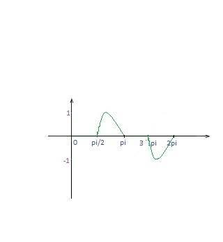

gneill thank you for your patience and help. I am attaching my sketch after your pointers. attaching progress sketch.

Okay, a couple of things before tackling the Fourier series. The first is a minor nit: In your function definition you have used ≤ for both of the segment ends where they transition from one segment to the other. This means that at the points where function changes from one segment to another the function would have two values (one from each segment) so it really wouldn't be a true function.
The second is that your sketch of the function doesn't look right. For example, the function should be zero until ωt is 90° (the first segment of the function definition) then it transitions to Vsin(ωt). Well, ωt is 90° at that instant, and Vsin(90°) = V, since sin(90°) = 1. In other words, your sketch should show a sharp jump from 0 to V at ωt = 90°. Similarly at 270° there should be another sharp transition but this time from 0 to -V, since sin(270°) = -1.
After you've sorted out your sketch, see if you can spot the overall function's period and then set up the integrals for the Fourier coefficients.

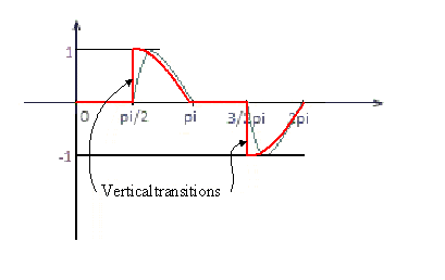

attempt to a sketch. that is what I understand has to be done. am I getting there ? thank you.

Closer. Note that the transitions from horizontal section to sine curve section should be vertical!

I'm not sure what you're asking here. My previous comment was to point out that the function makes a sudden transition from 0 to 1 at ωt = 90°, and from 0 to -1 at ωt = 270°. After the transitions the curve follows sin(ωt) until the next zero, where it goes back to a horizontal (zero) value for the next segment.
Perhaps you should plot a few points around the segment transitions to see.
