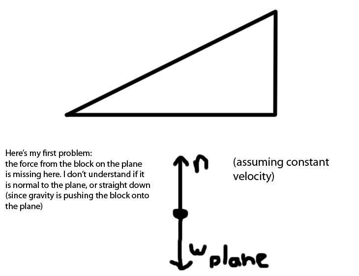

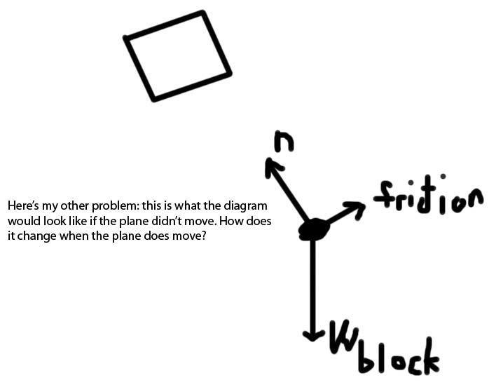

I have already identified the usual suspects:
Forces on plane:
- the force of gravity, acting downwards
- the normal force, acting upwards
- Additionally, I know that the plane is sliding along a level floor. Because there is no friction (stated in the problem), there is no force resisting the motion, and, assuming that it slides at a constant velocity, that means that there is no horizontal force acting on it at all (because the horizontal component of the net force must be zero)
- the weight of the block also acts on the plane, so we have another force acting downwards here.
Here comes the tricky part: I'm not really sure what makes the block move in the same direction as the plane. Is the plane pushing it? What force is that? I understand the other forces on the block (gravity, normal force, friction), I just don't understand what makes it "go along" with the plane.
Am I making any sense?
Thanks.

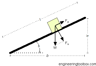

I think I understand what you're saying. It's hard to describe this without using images, but I'll try: let's assume that the plane looks exactly like this one (random picture I found online):
In this case, Fp would be friction if the plane didn't move.
Let us further assume that the plane is moving towards the left (after all, the problem doesn't specify). Are you saying now that this movement modifies the Fp vector?

The weight of the block acts on the block. But there is a normal force between the block and the incline.
Are you talking about the normal force of the plane pushing on the block? I do understand this force. But what force then, originating from the block, pushes back on the plane? Isn't that the weight of the block?

The plane pushes the block and the block pushes the plane: It is the interaction between them, and the direction of this force is normal to the surface between the block and inclined plane. You should draw a picture.
That's what I've been trying to do. I guess my main problem is that I don't know how to deal with the fact that the plane is moving. I think I could draw all the forces if it didn't...
I made two pictures to illustrate what I mean...

OK. But even when I don't assume constant velocity, the only thing this is going to change is that there will be an additional horizontal force acting on the plane, correct?
Well, it is not specified if the whole system has a constant horizontal velocity of not. That you can assume zero as the forces remain the same if a system moves with constant velocity with respect to an other inertia system. The horizontal position of the centre of mass of the block-incline system should be in rest as there is no horizontal external force acting on the system. If the block moves down along the incline, the incline has to move horizontally in the opposite direction.
ehild

This makes sense to me intuitively. What I still don't understand, however, is what the free-body diagram of the block would look like. To be more precise: is the diagram I posted correct?
Put differently: if I had to compare the free-body diagrams of the block once with the plane being stationary and once with the moving plane, what would be different?
I feel that I'm getting closer, but I'm still missing something...
Yes it is a question, with a moving constrain. But your forces have directions fixed to the incline, so draw them parallel and normal to it. So your free body diagram on the block is all right. As for the incline, the block and incline interact, so the same normal force and friction acts on the incline, with reversed directions.
ehild

Just to help me understand this better: what would change if there was a net force on the plane?
Than you would have include that force in the free body diagram. And if it had a horizontal component the centre of mass would accelerate. And it could happen that the block moved upward on the incline.
