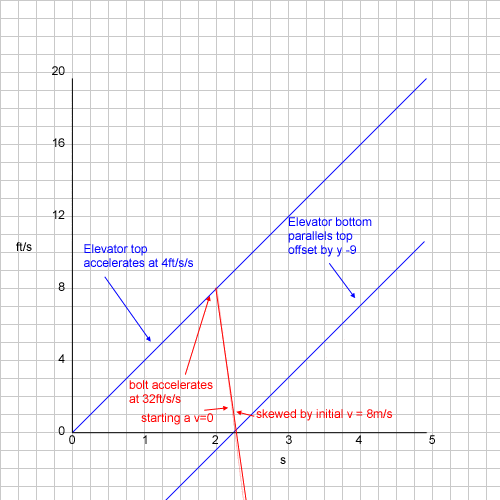

It's a two part question, but it basically says this:
a bolt drops from an elevator 9.0 ft from the ground, at what time does it hit the ground?
x = x0 + vx0t + 1/2ax(t^2)
since it's a free fall question and we're starting from above ground:
0 = 9.0ft - 16ft/s^2 (t^2)
-9.0/-16 = t^2
t = 0.75 seconds.
But the book says that t = 0.71 seconds..

What is the other part of this "two part question"? Is it possible that the 9.0 ft initial height was derived and thus possibly incorrect?
DaveC426913 said:
What is the other part of this two part question? Perhaps that factors in?
this is the full question:
An elevator ascends with an upward acceleration of 4.0ft/s^2. At the instant its upward speed is 8.0ft/s, a loose bolt drops from the ceiling of the elevator 9.0 ft from the floor.
Calculate (a) the time of flight of the bolt from the ceiling to the floor
(b) the distance it has fallen relative to the elevator shaft.
Answer: (a) 0.71 (b) 2.3 ft
I don't see how the other parts can affect the answer.. but there's a large chance that I'm wrong, I'm just learning physics myself through this book

That's quite a bit different from the problem that you stated and solved! You can't ignore the acceleration of the elevator.
hmm, but that is the acceleration going up isn't it? when it falls, wouldn't the acceleration just be gravity?
thanks
thanks
Yes but it's initial velocity is not zero. And the elevator floor is moving.
This is not a two-part question. This is a one-part question that has several dependent components.
The acceleration of the bolt is just due to gravity. But you are asked for the time until it hits the moving floor, which is accelerating. You need to combine both accelerations. (Write the position of the bolt and the elevator--with respect to the ground--as functions of time. Then solve for the point at which they collide.)
ohh. I thought that they meant the floor of the elevator SHAFT. thanks.

What do you mean? The initial speed of the bolt when it starts to fall from the elevator is the same as that of the elevator: 8 m/s upward. (After that, gravity exerts its influence, as for any projectile.)
I'm not sure I fully understand... the bolt is DROPPED, so its orientation is opposite to the upward speed of the elevator? I would be certain if the elevator and the bolt were going in the same direction...
thanks
Why opposite? It's dropped--not thrown or pushed.
Think of the example with the car. You're in a car, riding along at constant velocity. You drop something. Does that something start moving in the opposite direction? No, its initial velocity is the same as that of the car.
but being dropped is going down, so it's still opposite isn't it? since the elevator is going up
I can see your analogy but I'm having trouble accepting it (of course, that is entirely my fault). the claim seems to be "intuitive" but it isn't very intuitive to me..
when a speed is going in one direction, isn't there some kind of force that makes something go in that direction? if you drop something that isn't "going the same way", would it really have the same speed? perhaps I'm thinking of it like something going against the stream or a current?
sorry, but thanks for your patience
Yes, for as long as the bolt was part of the elevator, it was being accelerated by the same force that was accelerating the rest of the elevator.
When something is dropped, it just means that it is no longer traveling as part of whatever platform it was dropped off of.
The bolt, still connected to the elevator, was accelerated for some time to the velocity of the elevator. [tex]8 \tfrac{m}{s}[/tex]
At that point, it broke off. What force, exactly, changed its velocity from [tex]8 \tfrac{m}{s}[/tex] to [tex]0 \tfrac{m}{s}[/tex]?
That's right, none.
And according to Newton's First Law:
An object in motion tends to stay in motion, and an object at rest tends to stay at rest unless acted upon by an external force.
With no force to "remove" its initial velocity (Since it was traveling along with the elevator), the velocity of the bolt remains the same as it was the instant it detached from the elevator.
Just like how an object you drop out of the window of a moving car, has an initial velocity that's the same as that of the car the moment it was dropped.

Thanks, I'm starting to accept it.
"At that point, it broke off. What force, exactly, changed its velocity from 8 to 0?" Is a very good point.
But aren't things like velocity associated with a direction? so following that thought, if something is let go, it would go in the same direction as the rest of the object.. but then I think about it, since gravity is now asserting itself, it would start going downwards instead of upwards.. so is there a point in time "instantaneously" perhaps? where the bolt is going in the same orientation as the elevator? (or is this what this whole initial velocity thing was all about)
thanks
thanks
Gravity is an acceleration, it changes the velocity. As time goes by, gravity makes the velocity of an object be more and more "pointed down," for it to instantly change the direction of a velocity, the acceleration due to gravity would have to be infinite in size.
okay, I understand it, it makes a lot of sense. thanks everybody
