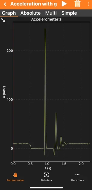

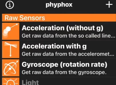

Get an app like https://phyphox.org/
which lets you get the raw accelerometer data.
While holding my phone at rest with my phone facing upwards, the accelerometer reads a_z=9.8\ \rm{m/s^2}.
After about half-a-second, I dropped my phone over the middle of a bed.
Note that, in freefall, the accelerometer read a_z=0.0\ \rm{m/s^2}.
It bounced and tumbled a little bit before coming to rest face up on the bed, when it reads a_z=9.8\ \rm{m/s^2} again.
