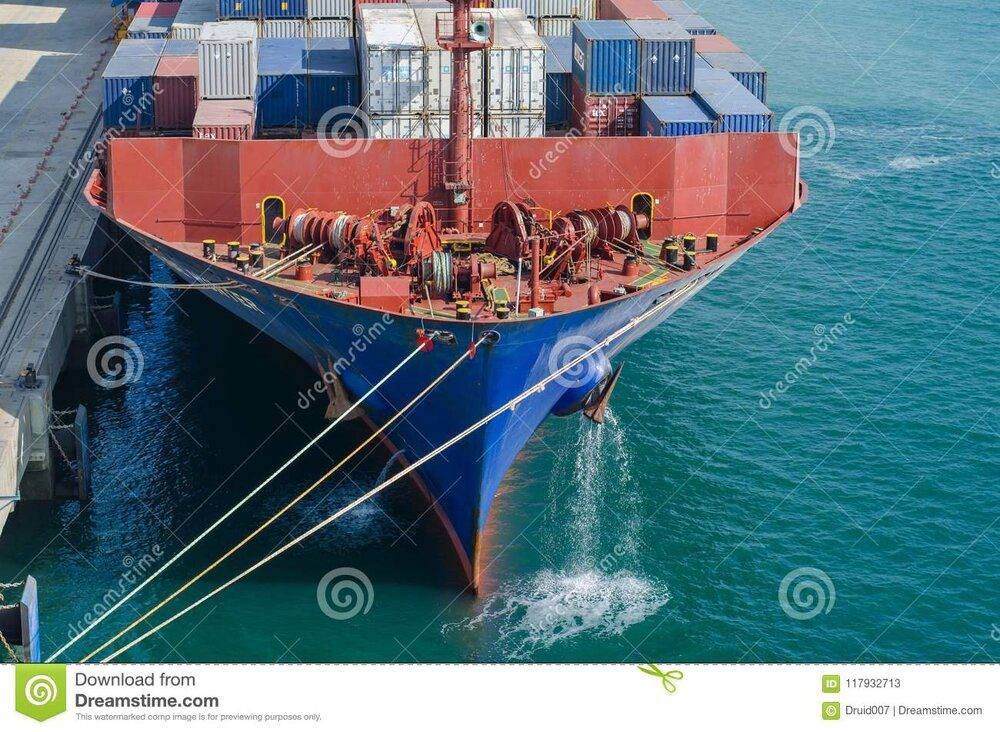

Won't work from front. My idea was about puling on the aft end, at a ~90 degree angle from across the canal.
There are even more on the back, but it is harder to get a good photo of their mechanisms. If you look at the stern of a container ship you will see a line of rectangular holes. If you look inside those you will see mooring attachment points and the emergency towing arrangement. You may also see these on the side, particular near the rear.
EDIT: Large ships aver these front and rear as they are maneuvered by tugs in harbor, and for emergency regulations.

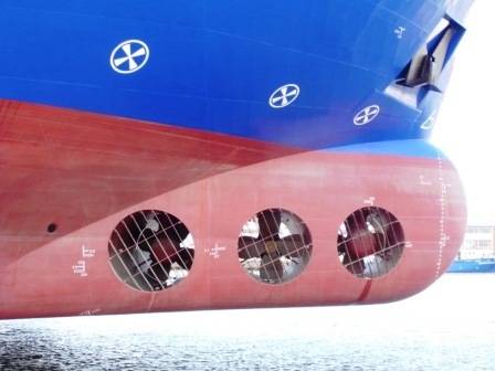

"For maneuvering in ports, Ever Given has two 2,500 kW (3,400 hp) bow thrusters."
Note the location of the two thrusters indicated by marks close to the water-line by the anchors.
The second picture shown in post ##16 seems to indicate that the sand/mud has reached those two cavities.
