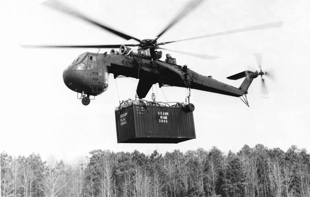

https://gallery.vtol.org/images/2017/04/08/USArmyAmes4.jpg
They said in the news here, that they assume the ship has dug its bow completely into the sandy ground, and its tail partly, too. I read that they ordered more tugs to avoid unloading the cargo, which they expect to take about two weeks. It isn't as if there was a harbor or container terminal nearby. It is also expected as a consequence that supply chains will break.
I guess you could pull an empty/returning cargo ship in close by and transfer half of the cargo by helicopter. I wonder if there are any empty cargo ships nearby...

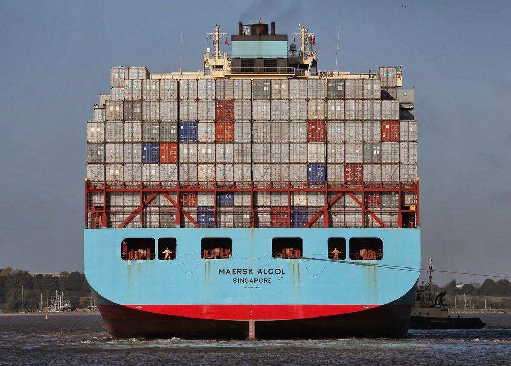

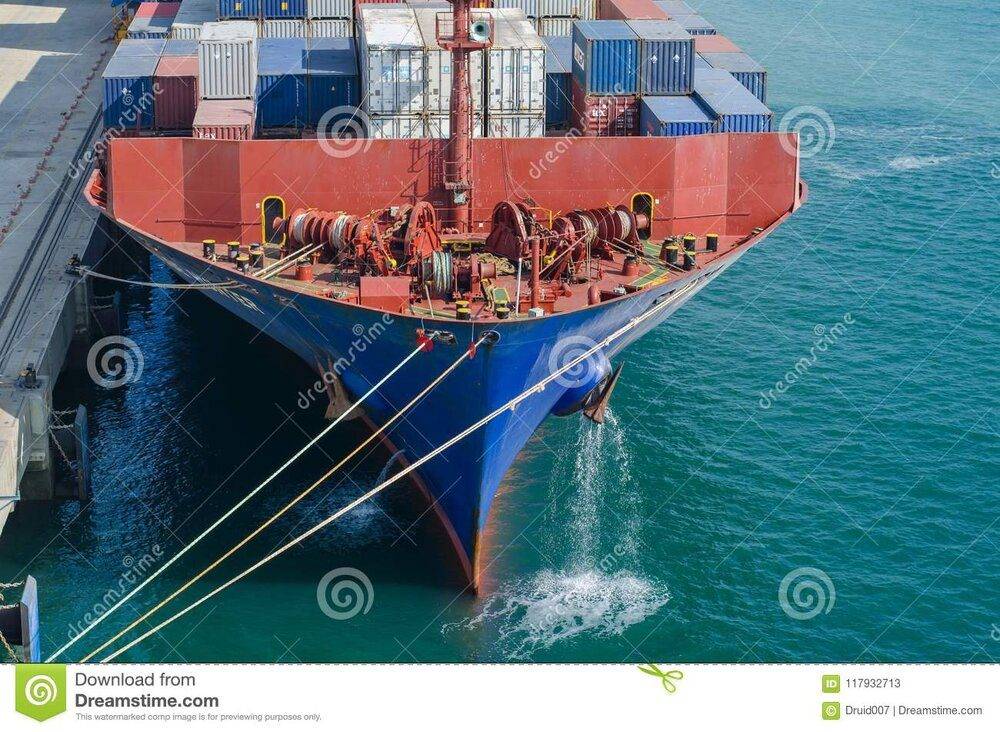

Apparently the ship length is comparable to the height of the Empire State Building in New York. Trust me, military Air-Ops can work with 40 helos in the air at once on this assignment. :smile:
fresh_42 said:
Fresh from the shipyard? Or a computer animation?
Probably just returning to home port to reload, I'd guess. I just used Google Images to find an empty container ship.

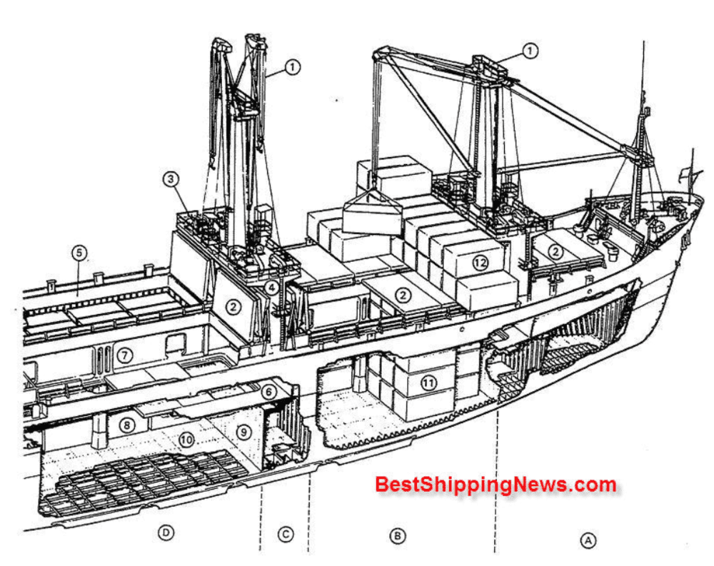

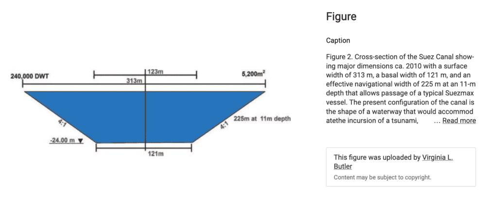

The cargo of containers would extend below the visible deck, deep into the hull.
The canal is at it deepest only in the middle:
To get its bow that far to the side would have required thee ship either plow into the sand or ride up the ramp of sand at the side.
I guess, once the front end was planted on one side, the ship would have pivoted cross the canal due to its forward momentum and jammed the stern over against the other side.

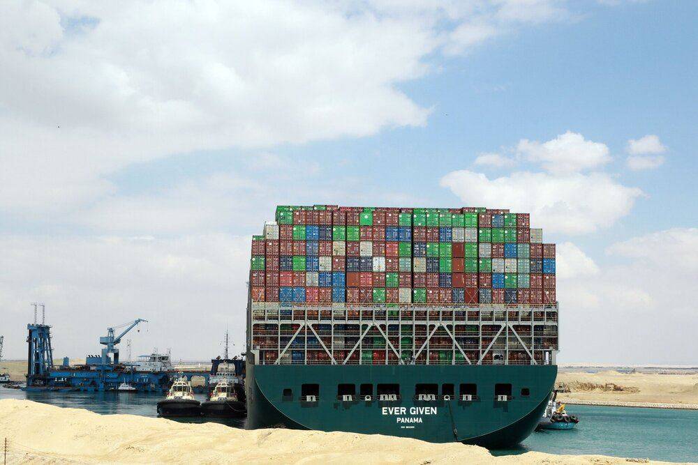

A quote from the Los Angeles Times, March 27, 2021, pg.A3
On Friday, dredgers capable of shifting more than 70 000 cubic feet of material per hour and teams of excavators were trying to dislodge the ship, said GAC, a shipping agent at the canal.
From the WSJ,
SUEZ, Egypt—Salvage teams are girding for another to attempt to free the Ever Given container ship that has been blocking the Suez Canal for five days, hoping that a higher-than-usual spring tide will help them unstick the 1,300-foot vessel from the east side of the channel.
People involved in the operation had earlier suggested the Ever Given, operated by Taiwan-based Evergreen Group, might have been freed as early as Saturday. A rescue team had earlier managed to free the ship’s rudder and start its engines after it veered off course during stormy conditions on March 23, blocking the critical trade route to traffic and disrupting global supply chains. Some 320 vessels are waiting to traverse the 120-mile channel, according to the Suez Canal Authority, which runs the waterway.
Dredging operations continued Sunday, and officials say they will try to free the ship with the help of the higher spring tide without having to unload containers to reduce its weight, which would be a difficult operation because of the location of the Ever Given.

Tugboats swarmed the large ship on Tuesday and Wednesday. The goal of the 2,000- to 3,000-horsepower boats is to coax the Ever Given back from the bank of the canal. If the tugboats pull directly back, they will create suction between the 220,000-ton ship and the shore that would make it even harder to move. Instead of tugging back, the tugboats are trying to change the angle at which the Ever Given is stuck.
From DW, "20,000 ton of sand have been removed from the area around the bow, and 9,000 tons of ballast water have been pumped out, in order to lighten the vessel. The operation has so far been unsuccessful - but two more tugs are on their way. If they can't move it, the next step will be to unload the cargo."

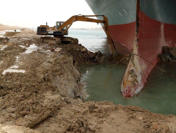

It's already hard to move.
Ever get a boot stuck in mud.
The mud has to be displaced by water. Since the mud is a 'solid' ( in regards to the fact that one can't walk though walls ) object, the water and mud have a difficult time exchanging positions, hence the suction. The suction is what is making it difficult to move, not that it is going to make it harder to move.
Assuming the bow is 300 feet wide x 30 feet deep frontal area stuck in mud. To pull the bow out, 300ft x 30ft x 14.7 psi x 14.7 psi = 290 M pounds of force, if air replaces the mud - ie pulling against an air vacuum. Of course that is a simplistic analysis, widely off, and doesn't take hydrostatic pressures into account, and would be not a figure to quote or base the amount of tugs one needs. It is just to illustrate the forces are extremely high, with the pushing and shoving possibly breaking apart a boat not used to forces in odd places on its hull.
I think someone can give a better analysis than I just did.
Nor go around quoting what I just did.
The bucket on a typical excavator is a yard of material, or 27 cubic feet.
