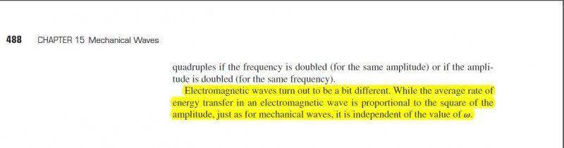

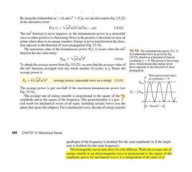

read page number 488 third line from above of Sear and Zemansky's University Physics 13th edition. Let me send a screen shot of the said paragraph.
unreadable ... what's your point ?
First its not my point its something conceptual that the book says...
"Electromagnetic waves turn out to be a bit different. While the average rate of energy transfer in an electromagnetic wave is proportional to the square of the amplitude, just as for mechanical waves, it is independent of the value of ω ."
