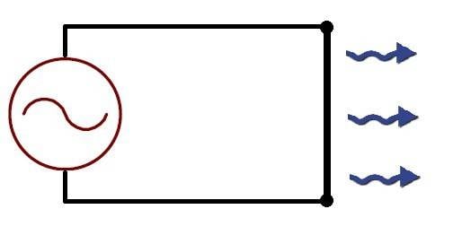

This is where my confusion still remains, and I think I have formulated a way of asking that will answer it.
Diagram of a sinusoidal AC source in a circle connected to a rectangular loop of wire, with three blue wavy arrows radiating out from the right-hand side of the loop.
Say the voltage source is given as [itex]v(t) = sin(2\pi t)[/itex] .
Now let the voltage source run for half a second (i.e. just the positive swing). This would be a pulse and generate radiation with a wide band of frequencies?
Now let the voltage source run for a full second. Now this would somehow produce only radiation at 1Hz?
1/2 a sec is a long time in EM, there could be 1000's of cycles depending on the frequency of your AC generator
what you have shown isn't really an antenna ... it's just part of the wires that are already connected to the ends

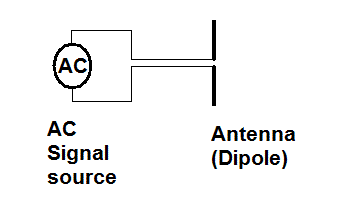

We can have the frequency wherever, and an actual antenna/transmitting circuit. My question is this: If we only allow the positive swing of the sinusoidal input to the transmitting antenna, this emits a wide band of EM radiation? But if you then allow the fulll swing, it will create an EM wave at only that specific frequency?
to show your schematic correctly
this is the way it could have been drawn more correctly :smile:
Circuit schematic of an AC signal source, drawn as a circle labelled AC, connected by two wires to a dipole antenna shown as two collinear rods, with labels 'AC Signal source' and 'Antenna (Dipole)'.
cheers
Dave
View attachment 209640cheers
Dave
Haha you there we go.
So my question still stands with this correct antenna circuit. If we only allow the positive swing of the sinusoidal input to the transmitting antenna, this emits a wide band of EM radiation? But if you then allow the fulll swing, it will create an EM wave at only that specific frequency?
It's a Loop Antenna. Its 'magnetic' rather than 'electric'. But the far field is still an Electromagnetic wave and indistinguishable from a wave from a more familiar dipole.

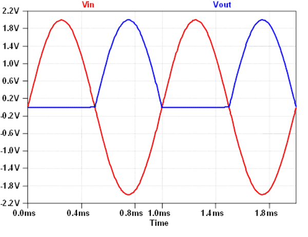

In the picture below, if you perform a Fourier transform on the red signal you will get one fundamental frequency. But if you perform it on the blue signal, you will get a bunch of harmonic frequencies? If that's true, and let's say the red wave can penetrate a certain substance very well, is it possible that a lot of the harmonic frequencies of the blue wave would be blocked by the substance and what you get out on the other side would be completely distorted?
Line graph of Vin in red and Vout in blue against Time from 0.0ms to 2.0ms; Vin is a sine wave of about 2V amplitude, while Vout is a half-wave-rectified sine with its negative half clipped to zero.
jaydnul said:
Ok thanks this helps a lot.
That is one method of Low Pass Filtering. Yes, if the low pass only let the fundamental through, you would get the same shape as the red signal (a sinusoid) but lower level.
