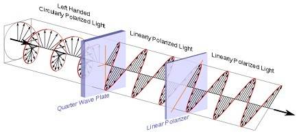

You often see the polarization of light represented this way:
Unfortunately, the axis is seldom labeled in this type of animation. I assume the horizontal axis is meant to represent space or time. The question I have is "Does the fluctuation frequency of the electrical field match the wave length of the photon?"
To be a little clearer, if you have a photon with quite a long wavelenth (say microwave at 21cm), the wavelength represents the changing probability of things like the photon being reflected when it hits a surface. I assume that the magnetic/electrical fluctuation represented by this picture happens much faster over a much shorter distance then 21cm.
Is that assumption correct, or does the electrical/magnetic fluctuation rate of the photon match its frequency?

To my knowledge the wavelength is the distance that the light travels in 1 cycle of its changing electric and magnetic fields while the frequency is how many times it switches per second.
Wavelength in free space (meters per cycle) * frequency (Hz : cycles per second) = c (speed of light in meters per second)

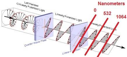

So there is nothing wrong with labeling a 532nm photon moving though space scaled in nanometers like this:

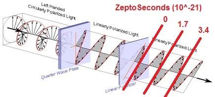

And the photon varies in time scaled by zeptoseconds like this:
This certainly makes things like Newtons rings easier to understand. It also makes it pretty obvious why the probability of reflection off a surface varies depending on how far the photon travels to get to this surface. The only thing I don't like about these animiations is the use of the second axis for the amplitude. You can model reflection in one dimension this way, but you cannot model refraction as the second and third axis are already in use.
