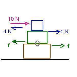

It's a pretty straightforward question but I suddenly had a conceptual problem. First off, I check the maximum friction between the 2kg and 3kg block (uN), and I get that to be 4N. So obviously the the resultant force on the 2kg block is 6N, and by Newton's second law, acceleration of he 2kg block is 3m/s2.
Next up, the 3kg block. So we know that by Newton's third law, an equal and opposite force ( I.e 4N) will act on this 3kg block because of the friction between it and the 2kg. Upon checking the maximum frictional force between the 3kg and 7kg block, we find that it is a whopping 18N, so there will be no motion, (and another 4N will act on the 7kg block, quite obvious). THIS IS WHERE I HAVE A PROBLEM. According to my textbook, this means that the 3kg block will be at rest "with respect to the 7kg block", and hence acceleration of both 7kg and 3kg block will be the same, i.e 0.4 m/s2. Why do they say that it is at rest only w.r.t to the 7kg block? Since the net force acting on it is zero, shouldn't it just be at rest, and not move at all? And therefore shouldn't the 7kg block move with an acceleration of 4/7 m/s2? I'm thoroughly confused. By their logic, wouldn't that also mean that the 2kg block is accelerating with an acceleration of 3m/s2 w.r.t to 3kg block (not w.r.t the ground)? A detailed explanation would be appreciated, thanks all!

The 2 kg block slides on the 3 kg one, so it is kinetic friction between them. Kinetic friction has a definite value, 4 N.
The force of kinetic friction between the 3 kg block and the 7 kg block would be 18 N backwards. The 4 N force exerted by the upper block is not enough to overcome it. So the 3 kg block can not slide on the 7 kg block. They interact with static friction, which is less then 18 N.
The 3 kg block and 7 kg blocks move together as a single body on the frictionless surface. What forces act on that body? What is its acceleration?
If you know the common acceleration both the 3 kg block and the 7 kg block you can find the force acting between them.
Free-body diagram of three stacked blocks: a small blue block on top, a green block in the middle and a brown block at the bottom on a horizontal line. A pink 10 N arrow points right at the top block, blue arrows show 4 N on the top block and the middle block, and green f arrows show friction forces between the blocks.

It is be true if the body does not move. But those boxes will accelerate with respect to the ground. See the picture attached to my previous post.
I see. That diagram makes things quite clear.

Just in the same way. You assume that they accelerate with respect to each other, and if that proves to be false you stick the two boxes together and treat them as a single body.

You considered the forces acting on the middle block, assuming it slides on the 7kg one. There was the 4 N forward force from the interaction with the 2kg block. Sliding friction on the top of the 7 kg block would mean 18 N backward force, what the 4 N force can not overcome. So there is no sliding, the 3 kg block moves together with the 7 kg one.
