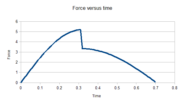

I modeled it as a spring with two different constants, a higher one during compression and a lower during relaxation. As you can see, the rebound takes longer.
Line graph titled "Force versus time": force rises roughly linearly from 0 to about 5.2 at t ≈ 0.31, drops sharply to about 3.3, then falls smoothly to 0 at t ≈ 0.7. Axes: Time 0 to 0.8, Force 0 to 6.

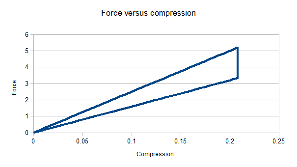

Read the next chart as clockwise around the loop. The enclosed area represents the net KE lost.
Line graph titled "Force versus compression": a closed loop from the origin, with force on the y-axis (0 to 6) against compression on the x-axis (0 to 0.25). The upper, steeper branch rises to about 5.2 at compression 0.21, then drops vertically to about 3.4 and returns to the origin along a shallower line.

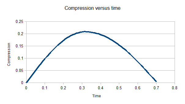

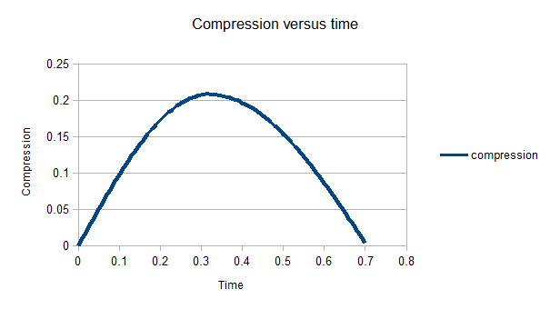

And for completeness:
Line graph titled Compression versus time: compression rises from 0 at time 0 to a peak near 0.21 at about 0.32, then falls back to 0 at about 0.7.
  • Line graph titled Compression versus time: compression rises from 0 at time 0 to a peak near 0.21 around time 0.32, then falls back to near 0 at time 0.7. Axes run 0 to 0.8 for time and 0 to 0.25 for compression.
