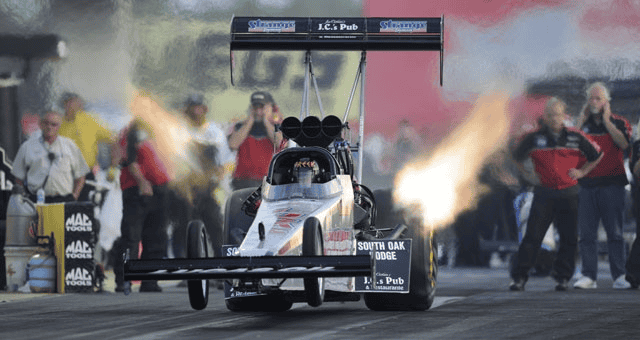

Have you ever been to a drag race? Why don't pavement dragsters use 4WD? :wink:
And that "hint" is silly...
[Hint: Consider the normal force on each tire, assumed equal.]
Drag race? Can they run wearing all those high heels? ;).
