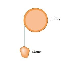

A frictionless pulley has the shape of a uniform solid disk of mass 5.00 kg and radius 28.0 cm . A 1.40 kg stone is attached to a very light wire that is wrapped around the rim of the pulley, and the stone is released from rest. As it falls down, the wire unwinds without stretching or slipping, causing the pulley to rotate. How far must the stone fall so that the pulley has 3.10 J of kinetic energy?
Here's the given figure:
Diagram of a solid disk pulley with a light wire running from its rim down to a stone hanging below, labelled pulley and stone.
Rotational KE = (1/2) Iω2
K1 + U1 = K2 + U2
ν = rω
a(tan)= dv/dt = r (dω/dt) = rα
Part A: Forces doing work on the system? Gravitational force
Part B:The magnitude of the velocity of the stone is the same as that of the point of contact.
Part C: How far must the stone fall so that the pulley has 3.10 J of kinetic energy?
I'm confused as to how I'm supposed to go from the above equations to finding linear displacement. Does this problem involve an integral of some kind?
Thanks so much!
If the pulley has a certain amount of kinetic energy, how much kinetic energy must the stone have?
