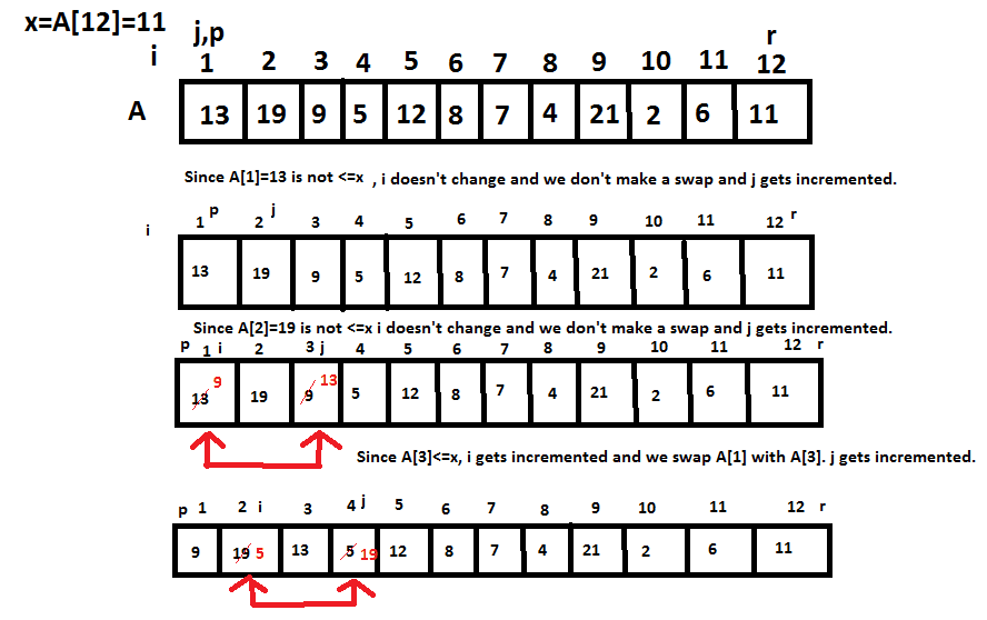

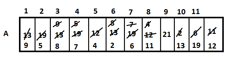

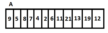

I have to describe the function of [m] partition [/m] at the array: $A= \langle 13, 19, 9, 5, 12, 8, 7, 4, 21, 2, 6, 11 \rangle$.I found the following:
So the final form of the array is:View attachment 4067
But how could I describe the function of [m] partition [/m] at the array? (Thinking)

I have to make a step-by-step trace and write at each step what the algorithm does.So do I have to write at each step the value that [m] i [/m] gets and the swap that is done?
I suggest writing at each step the value of [m]i[/m], [m]j[/m], and the full contents of [m]A[/m]. (Wasntme)

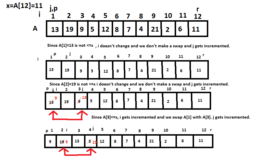

So should I do it in the way as follows? (Thinking)
Or should I write it in an other way?
Looks good. (Smile)
Do you already have an idea what is happening? (Thinking)
Where do the elements that are smaller than $x$ end up? (Wondering)
I like Serena said:
Looks good. (Smile)
$x$ ends up at its right position and at its left there will be all the elements that are smaller than $x$ and at its right there will be all the elements that are greater than $x$, right?So after drawing 11 times the array, should I write this conclusion? (Wasntme)
Yep.
If it were me, I'd skip a couple of steps, since I'd already know what was happening.
And then I'd write down the last 2 steps or so, followed by the conclusion. (Wasntme)
