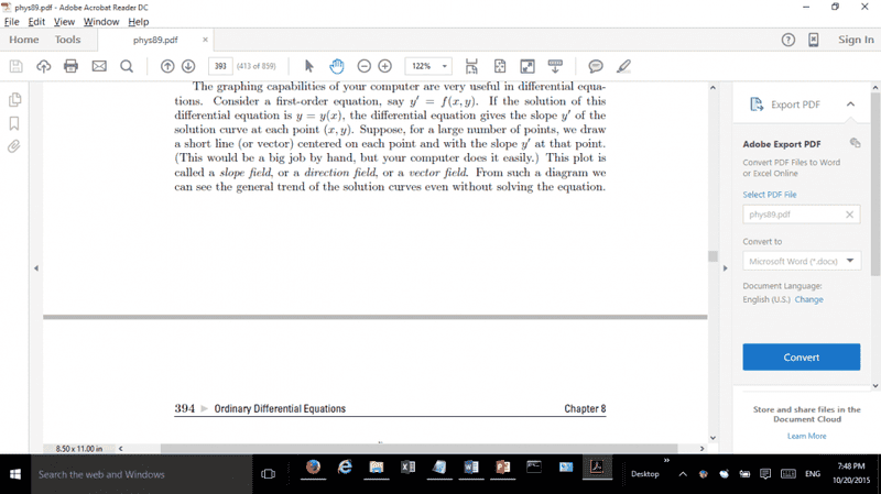

Printed textbook page on ordinary differential equations: text explains that y' = f(x, y) defines a slope field, with the solution curve y = y(x) and a short line drawn at each point. Page footer reads 39-4 Ordinary Differential Equations, Chapter 8.

##y'=f(x.y)## is a function of two variables. ##y=y(x)## is a function of only one variable. How can they be related? Clearly ##y(x) = f(x) \neq f(x,y)##

The right side of the differential equation y' = f(x, y) involves expressions in both x and y. For example, something like y' = 2x + 3y. Here f is a function that maps a pair of numbers (x, y) to 2x + 3y.
We generally assume that y is related to x in some way.

Perhaps ##f(x) \neq y(x)##
Correct.
