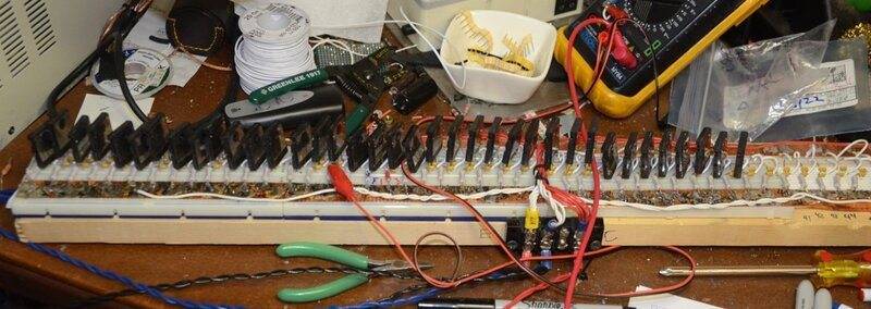

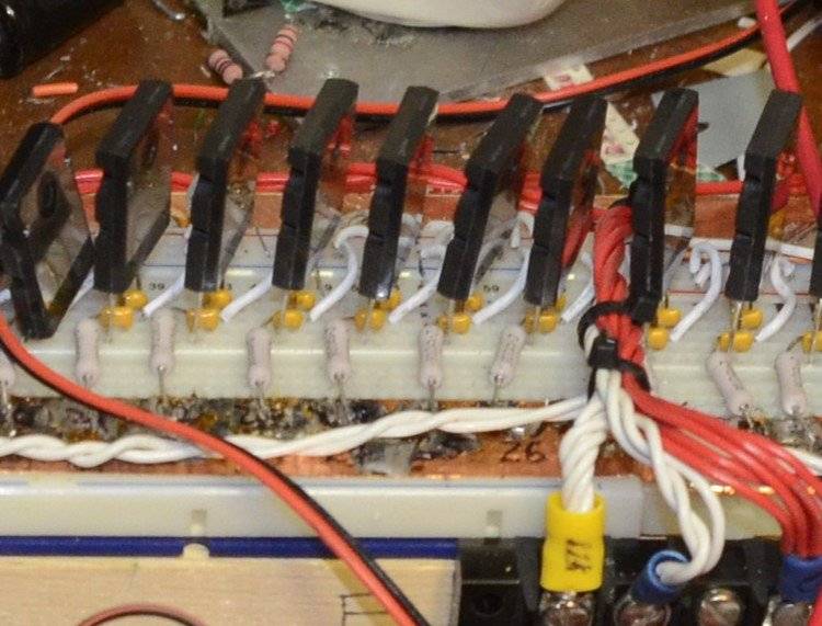

I design audiophile power amps as hobby. I need to match power transistors. It is A LOT HARDER than I thought. I built a test fixture to hold up to 50 transistors at a time. I try to match sets of 13 to about 1mV which is very tight as Vbe change is about -2mV/deg C. I have to move transistors around to get matching set all in a roll, not from far apart.
I set Vc=1.4V, emitter resistor is 910ohm and goes to -5.6V to get about 5mA of current through. I keep current and collector voltage Vc low so I won't cause big rise in temperature. Also I keep current low so the contact resistance of the proto plug in board will not cause problem. Below is the pictures to show:
One thing I notice that is very strange, if I pull the transistor out, then plug it right back in, the Vbe decrease by about 2mV. If I repeat on the same transistor again, it's will further decrease. It will take about 10mins sitting with power on to stabilize back to the original value.
I don't think my fingers will cause the temperature to rise so fast, I measure, pull out, plug in and measure, Whole process is less than 10sec. Another thing more important that convince me it's not the problem is it will take at least 10 minutes to go back to normal. It it is thermal issue, the heat up and cool down time is very different, 10sec to heat up, 10 minutes to cool down. I don't buy that at all.
Any explanation on this?I can assure anyone that is interested, matching is A LOT harder than it sounds.

You warm it in your fingers.
-2.5 mV per degree centigrade for silicon.
Fast conduction heating between fingers, slow convection cooling in air.
-2.5 mV per degree centigrade.
I just edit to describe I don't believe it is. I know it's temperature sensitive, but it takes 10mins to go back to normal, I don't believe my finger heat it up in 10sec, and takes 10 minutes to cool down.
BTW, I know it's temperature sensitive, I hold the transistors by the side that is plastic. I avoided touching the back where it goes onto the heat sink. There is no way the plastic can conduct the heat in 10 sec. to raise 1deg.
The rate of heat transfer is proportional to temperature difference.
Your fingers are significantly hotter than the transistor environment, so heat travels into the package as a wave, reaching the semiconductor over a longer period.
If it heats by 1°C, then it will cool very slowly, since it is close to the temperature of the environment. The test would be to use a tool at the same temperature to remove and return the device from testing.

Maybe it's this fast. I use the pliers to pull and plug back, it rise 0.2deg C.
Thanks, I can't believe it's that fast as I hold onto the plastic only for a few seconds.
Thanks
AlanEDIT: I am really surprised how can those non metal material conduct heat so fast? If you look at the picture, there is no metal on the side. I was so careful about it.

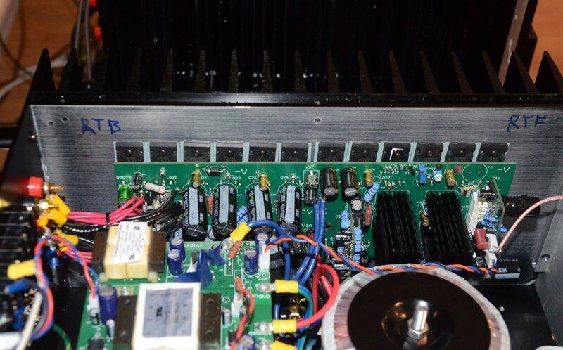

I design very high end hifi power amps. I use 12 pairs of output transistors at bias current of over 100mA each. Without getting into detail, the best crossover characteristics is when the emitter resistor only drop about 28mV. This means if the transistors are NOT matched, even if it is off by like 5mV, there will be significant difference in current between transistors.
The thing is tempco of BJT is -2mV/deg C. The hotter it is, the lower the Vbe, so the one with the lowest Vbe will draw more current, in turn Vbe drops further and draws more current and can go into thermal run away.
It is NOT that simple when you get into extreme high end design. My amps are competing with ones that are over $4K power amps. It's nothing like those low bias class AB power amps that use only 2 to 3 pairs of transistors. Those you can design blind folded.
Believe me, when comes to sound quality, the more pairs of output transistors, the better it sounds. You cannot quantify by measuring THD, those means nothing. It's more important to lower the output impedance( NOT by closed loop feedback) particularly open loop output impedance.

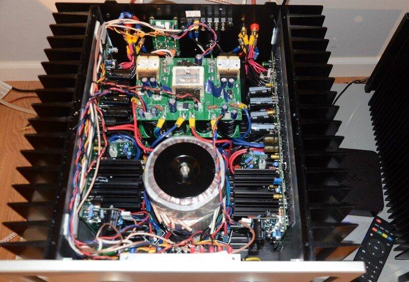

I finally finished building my amp. Here are 3 pictures:
Even though this is home built, it's all pcb, terminal blocks, crimp wires. Everything done like production products. I compare my amp to commercial amps even in built quality. I have no plan in making it a business. There's no money in very high end audio stuffs. Cost me a little over $1,000 just for parts to build one amp(no snakeoil stuffs, components are just from Digikey, wires are the cheapest ones from ebay). It has 12 pairs of power transistors per channel. I have 4 separate power supplies, two for each channel, separate regulated supply for the frontend and big supply for the output section. But I really enjoy this.

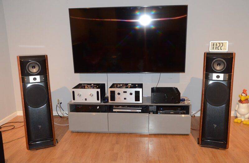

Oh yeh, the speakers, speakers placements, speaker cables are just as important. This is my living room:
I bought the speakers used, still $6000USD, new price in 2003 was over $15K. Notice I have black tapes at the foot of the speakers, I had to move inch by inch, turning the speaker angles a little at a time to optimize the sound stage. I used to build my own speaker cables. It's not the wires that make a difference, it's how many smaller insulated wires that make the difference. I used 6 pairs of 16gauge wires to make the cable twisted together. Against the common believe that the resistance of the wire is important, it's the INDUCTANCE of the wire that is important. If you look at the inductance per unit length of wires of different gauges, you'll see a 12 gauge wire is only slightly less inductance than a 16gauge. The way to reduce inductance is use many small wires in parallel, tightly couple together to minimize inductance. Just draw the equivalent circuit of the output impedance of the power amp through the cable to the LRC equivalent of the speaker, you will see the the importance of lower inductance of the cable. You also will see the resistance of the wire is NOT even in the picture. Now I use a Chinese copy of Kimber Kable speaker cable, same idea, just better looking for the living room. It is not sounding any better than my home built cheap ebay copper clad aluminum(cheapest kind) wires. I concluded the kind of wire is not even important as resistance is not even in the picture. Calculate the reactance of the wire and you'll see.
I just use any DVD and CD players, I don't think the low signal level section is important at all. same as the interconnect coax cables. I just buy the thicker ones from Amazon. It's only from the power amp to the speakers that is very critical. I built my own preamp, just an audio jFET opamp to buffer the signal from the DVD players with a volume control, nothing mystery in that. Funny I find jFET opamp sounds better, but still ala Digikey! About like $2 ea. I am born CHEAP, I don't spend an extra penny if I don't have to. The only thing that is expensive in my amp is the CHASSIS, believe it or not, it's $500USD including shipping from China. The shipping today is more than the chassis itself!
In the picture, you see 3 amps I built.
Too bad I don't know anything about speaker design, or else I would not pay that kind of money. Also, I don't think my big boss like to have a home built speakers in the living room. She's picky and my carpentry work is less than desirable. I know my limits.
