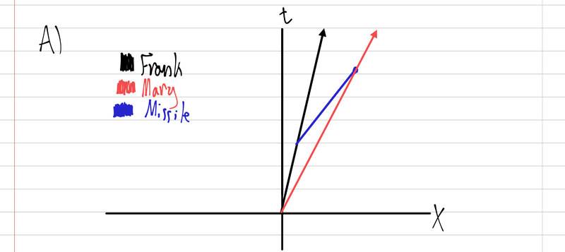

Mary and Frank are each in their own rocket ships moving along the x-axis. Mary's ship passes Frank's ship at t0=t0'=0 with a speed "v" to the right. When t=t1 in Frank's frame, Frank shoots a missile with a speed "u" where u>v in the direction of Mary. At time t=t2 in Frank's frame the missile hits Mary's ship.
a. Show the process of events on an x-t diagram showing Frank, Mary, and the missiles position as a function of time.

Ignore what I believe to be an inconsistency, I drew this picture of their positions with respect to time from an observer's frame.
script>
Hand-drawn x-t diagram labelled A) with t on the vertical axis and X on the horizontal axis. Black line for Frank and red line for Mary both start at the origin; blue line for the missile starts on Frank's line and ends on Mary's line.

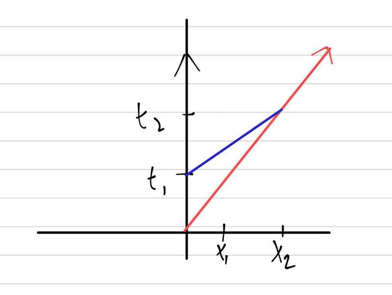

and this one from Frank's frame
script>
Hand-drawn x-t diagram with horizontal x axis marked x1 and x2 and vertical t axis marked t1 and t2. A blue line starts at t1 on the t axis and rises to a point at x2, t2. A red line starts at the origin and passes through that same point, extending with an arrow beyond it.
to b) and c) I wrote that Mary's slope is v and the missiles slope is u, while both their y-intercepts are 0 because they're both moving along the x-axis. (I'm unsure if by y-intercepts it actually means t-intercepts)
but I get stuck on d), e), and f) using either method

Hi Shadowmaker,
The wording seems OK. You asked, "speed v relative to what?" This is the speed of Mary relative to Frank.
Yes, Mary is traveling to the right.
In Frank's frame, Frank's speed is zero of course.
Your first diagram appears correct. However, I believe it could be simpler; You could use Frank's frame as the observer, in which Frank's speed is zero and so his line would vertical. I see you did this on your second diagram and this looks right to me.
The y intercept of course means when t=0, as I think you understand. Mary's y intercept in Frank's frame would be at the origin, which you have correctly shown in your second diagram.
The "y intercept" of the missile, in Frank's frame, would be at t=0 which is before the missile is fired. So I agree with you that it seems more reasonable to talk about the t intercept, which is when x=0.
Regarding part d, your equation t2 = (ut1)/(u-v) seems right. I notice that if u=v, t2 is infinity. This means that the missile never hits Mary's ship, which is of course correct.
However, your equation x2 = ((u2t1)/(u-v)) - t1 cannot be correct because x2 is a distance, while the second term on the right, t1, is a time.

Thank you very much! I already turned it in, but I believe I had the right answers before I did so, what you’ve written increased my confidence.
I did end up looking for the t intercept ultimately.
I used line the y=mx+b line form with the understand that the slope was actually 1/v and 1/u.
Since Mary’s t intercept was 0, hers was just y=mx.
In frank’s frame X1 = 0.
My last edit was using the mechanics formulas. I wasn’t sure about the time I got but I knew that the x2 was wrong because from mary’s frame, the missle at t2 should be at her 0.
Using the line’s formulas instead I got x1 = 0, t2 = ut1/(u-v)
And for x2 I believe* (as it’s not with me anymore) I got uvt1/(u-v) and when I converted it to x2’ it came out to 0 which is what it should have done.
Thanks!
