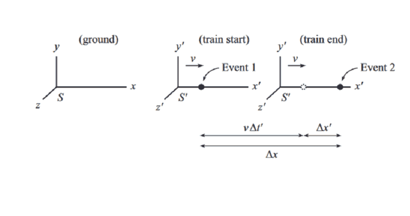

From my limited understanding the Galilean transform has 2 frames but 4 four perspectives. For example x is the stationary frame when using
## ∆x = ∆x′ + v ∆t ## and x' is moving. When using ## ∆x' = ∆x - v ∆t ## and x' is stationary and x is moving.
Now lets use the example of ## ∆x = ∆x′ + v ∆t ## . Delta x' represents the event in (x')'s frame and if the object is moving it will have a time and velocity.
By 2 events I mean ##x'## position and ##v ∆t## represents the second event the first object moving.
Is this explanation correct?

Take the picture below. ## ∆x = ∆x′ + v ∆t ## . x sees x' moving . I have 2 perspectives here. I kind of just invented the term perceptive. While if I switch to ## ∆x' = ∆x + v ∆t ## x' is stationary and x is moving.
I would also need 2 graphs where velocity is negative and is traveling in the opposite direction and another graph where x was stationary.
So to keep it short perceptive = the number of graphs.
I realize there are 3 graphs but I think 2 of them could be combined in the picture below.
Should I site where I got the picture from?

I don't really understand what you are asking. In this case, we have something like:
Train frame: a passenger is walking down the train - a dispacement of ##\Delta x'## (Perhaps she walked from one seat to another seat on the train. The seats are ##\Delta x'## apart.)
Ground frame: the passenger is moving with the train and walking down the train. In this frame her displacement is ##\Delta x##, which is a combination of the movement of the train and the movement of the passenger relative to the train.
The Galilean transformation allows you to express ##\Delta x## in terms of ##\Delta x'## and the movement of the train, which is ##v \Delta t'##. Your diagram illustrates this:
jimmy4554564 said:
In short:$$\Delta x = v\Delta t' + \Delta x'$$Is that clear?

The images you are showing are illustrating why the transformation takes the form it does. The opposite illustration will just be a redrawing of the same thing.
