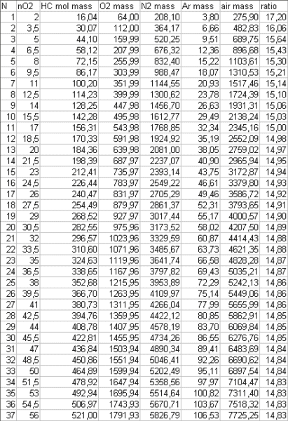

I think i have the solution to your problems. A 14.7:1 ratio can be calculated for any fuel with CnH2n formula. Just try it. When performing the calculation, you can let the 'n' there alone, you don't need to substitute it with any number and in the end it will cancel off to get 14.7:1 ratio
Cheers!
Masses in g. It converges on 14.83 in my calculations, could be they used slightly different air composition (21:78:1 in my case). HC stands for hydrocarbon.
  • Spreadsheet table of combustion stoichiometry values by row N, with columns for nO2, HC mol mass, O2 mass, N2 mass, Ar mass, air mass and a ratio that falls from 17.20 toward 14.83 as nO2 rises from 2 to 56.
