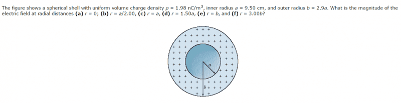

Okay, parts a-c are zero as they are within both shells.
Lets begin with d because i fear I am just repeating the same error in all of the following parts.
Part d
qenclosed=ρ(4πr^3/3-4πa^3/3)
= 1.98E-9(4π(1.5*.095m)^3/3-4π(.095m)^3/3)
=1.69E-11
E=qenc/(4πΣor^2)
=1.69E-11/(4π(8854E-12)(.1425)^2)
7.475 N/C
Now for e it should be the same process as r is equal to b and for part f the equation should be:
E=(ρ/(3Σo))*((b^3-a^3)/r^2)
=1.69E-11
Check that.
Your approach to each part looks right.
