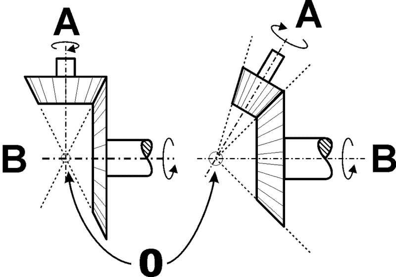

Suppose I have a device in which manually rotating gear A clockwise causes gear B to rotate clockwise. If gear A and gear B are at a weird angle to each other (say 35 degrees), what sort of intermediate parts could I use to achieve this rotation?
I've been reading about bevel gears and helical gears, but it seems like bevel gears are only used to change the axis of rotation by 90 degrees? I could be mistaken. Any thoughts on possible configurations are appreciated! Especially well-known configurations for this kind of thing.

Just have the driven gear turned around facing the opposite direction.
The axes don't have to be at 90 degrees, that's just probably the most common configuration.
oh cool! so bevel gears specifically can be used at random angles like 35? or other types?

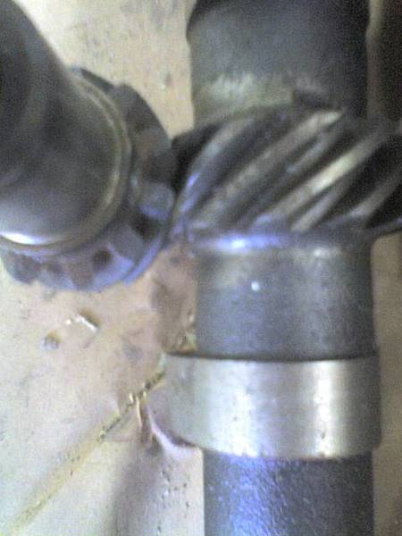

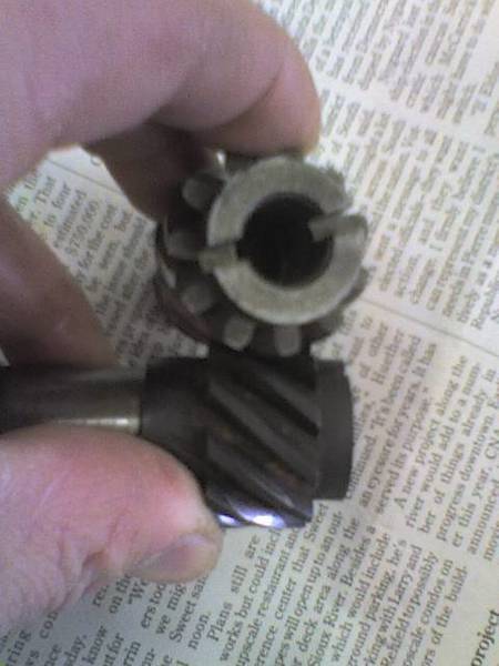

The first two pix are of an oil pump gear and the camshaft that drives it. Notice that the teeth are not cut at the same angle. The last pic is of 2 identical oil pump gears meshed. They are not meshed at 90 degrees although it looks like it. It is difficult to get a pic that shows this. So, are you saying that although they mesh, and they are meshing at an angle that is niether 90 degree cross or parallel, there is some reason why one would not drive the other?
I don't know. But, I want to take back what I said in post #11. I still don't think you can set them different than parallel or 90 degrees, but I just don't fully understand why (and indeed, if)...and don't have time to figure it out right now.
Helical gear can be used at any shaft angle.

Bevel gears can be used at through a range of angles, but their shafts must be in the same plane. Helical gears can also be used through a range of angles, but the plane their shafts can be rotated in must be parallel planes. Worm gears can also be designed for use in a range of angles, their shaft alignments are restricted similarly to helical gears. There are also spiral-bevel gears (a combination of bevel and helical) and hypoid gears that can be used in a range of angles, their shaft alignments are not as restricted as for other types of gearing.
