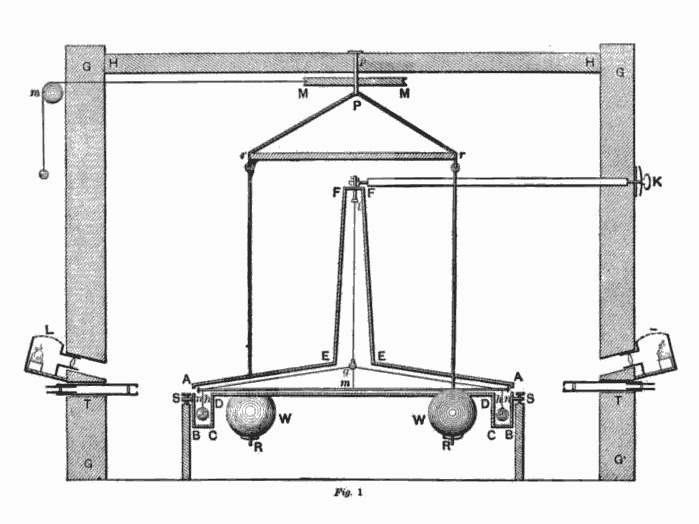

yes, day-to-day objects do produce a gravitational force on each other. Of course, the gravitational force between two chairs is very weak compared to friction forces and Earth's gravity, and other forces. So most of the time, we don't need to take into account the gravitational force between two chairs.
But it is non-zero! And can be measured. I think the first time that the gravitational force between two objects (of day-to-day size) was measured, was in 1797, called the Cavendish experiment.
Wow that is a very remarkable experiment, given the technology used! Looks like "L" is a light source via fire lol. Wiki says John Michell devised the experiment, genius!
