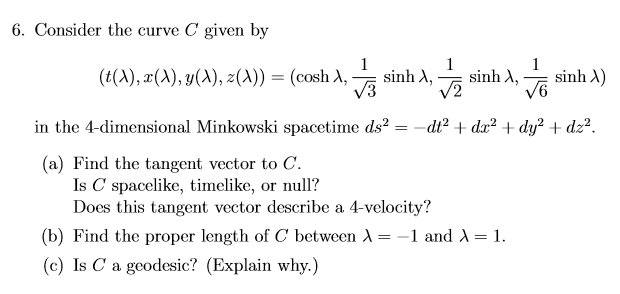

question attached
Attempt :
Check if ##V^{\alpha}\nabla_{\alpha}V^u=0##

Which part of the question are you trying to answer in your attempt in post #1? (If you're trying to answer part (c), that depends on the answer to part (a) which you haven't shown.)

I am attempting part c)
For part a) you simply differentiate w.r.t ##\Lambda## and then compute ##g_{uv}V^vV^u## and check it's sign. ## < 0 ## here being time-like from the chosen metric convention.
Therefore I would identify a failure to make a connection between these two parts of the question as a mistake in the attempt, rather than purposely not showing to attempt question a, because I thought this wasn't as issue to me. Pretty much then, my approach to the question is wrong, which is all needed to be said.

Are you sure? What are your components ##V^\mu## explicitly?
For part (c), can't you simply evaluate ##dV^\mu/d\lambda## (since the connection is 0 in Minkowski spacetime) ?

My second post was exactly this? To evaluate ##dV^\mu/d\lambda=0##. My question was this is 4 separate equations? So to check whether it's a geodesic or not you check whether all four equations are consistent in the ##\lambda## which solves them?
For part a)
##V^u=( sinh \Lambda, \frac{1}{\sqrt 3} coshh \Lambda, \frac{1}{\sqrt{2}}cosh \Lambda, \frac{1}{\sqrt{6}}cosh \Lambda) ##
So the check for part c) returns the components of the original vector as four separate equations. My question was concerning solving them anyway. THIS: So to check whether it's a geodesic or not you check whether all four equations are consistent in the ##\lambda## which solves them?

I think you're overcomplicating this. To be a geodesic you'd need ##dV^\mu/d\lambda=0## for all ##\lambda##.

but ##\mu## runs over ##\mu=0,1,2,3## so need to solve, there are four equations to check, what am i over-complicated, don't we need to solve the following system of equations? To which the answer will be inconsistency due to the non-linear dependence of sinh and cosh?
## \frac{dV^{0}}{d\Lambda}=0##
## \frac{dV^{1}}{d\Lambda}=0##
## \frac{dV^{2}}{d\Lambda}=0##
## \frac{dV^{3}}{d\Lambda}=0##
I get the feeling you're not reading my reply hints carefully enough. I'll try one more time:
Note the "for all ##\lambda##" part.

but there are four equations?
so this would have only happened if ## V^{u} ## components were constants indepedent of ##\Lambda##?

So? It's a single vector (which has 4 components).
so this would have only happened if ## V^{u} ## components were constants independent of ##\lambda##?
If by "this", you mean "the curve would be a geodesic only if..." then yes -- because you're working with Minkowski spacetime in this question.

As in this is the expected result since we are in flat space-time?
I don't think I'm picking up what you are saying properly, could you explain a tad more?

In Minkowski spacetime, with metric ##(-1,+1,+1,+1)##, the Christoffel connection coefficients are all 0. So the equation for a geodesic curve (in terms of an arbitrary parameter ##\lambda##) is just $$0 ~=~ \frac{d^2 x^\mu(\lambda)}{d\lambda^2} ~\equiv~ \frac{dV^\mu(\lambda)}{d\lambda} ~.$$ So if this equation is not satisfied (for any component), then the curve is not a geodesic.
