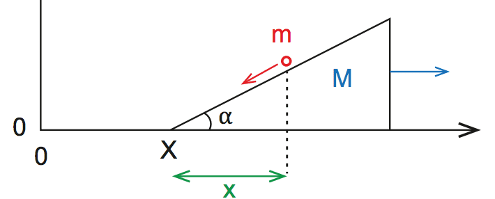

In this example, I know that I can define the horizontal contribution of kinetic energy to the ball as ##\frac{1}{2}m(\dot{x} + \dot{X})^2##.

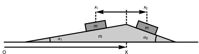

In the following example,
Mass ##M_{x1}##'s horizontal contribution to KE is defined as ##\frac{1}{2}m(\dot{X} - \dot{x_1})^2##. Why is this? I have a hunch that it is due to the "origin" (##X## line) ##x_1## and ##x_2## originate from, though I can't exactly put my finger on the exact reason.
Assistance is greatly appreciated!

It has to do with the way the generalized coordinates are defined. In the top drawing ##\dot{x}## increases to the right (although not clear from the double arrow) so the velocity relative to the ground is ##\dot{X}+\dot{x}##. In the second drawing, ##x_1## increases to the left while ##X## increases to the right, so the relative velocity would be ##\dot{X}-\dot{x_1}##.
Thanks for the response,
Would I be right to say that this is also the result of vector addition? Edit: With ##x_1## being defined as positive vector
You could say that considering that it involves defining cartesian coordinates relative to origin ##O_1## and then adding a cartesian coordinate to define origin ##O_1## relative to new origin ##O_2##.
