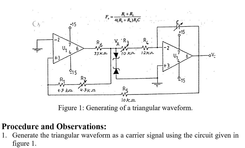

Attached below.

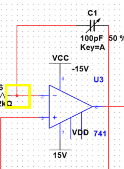

Using any Electrical Engineering software:

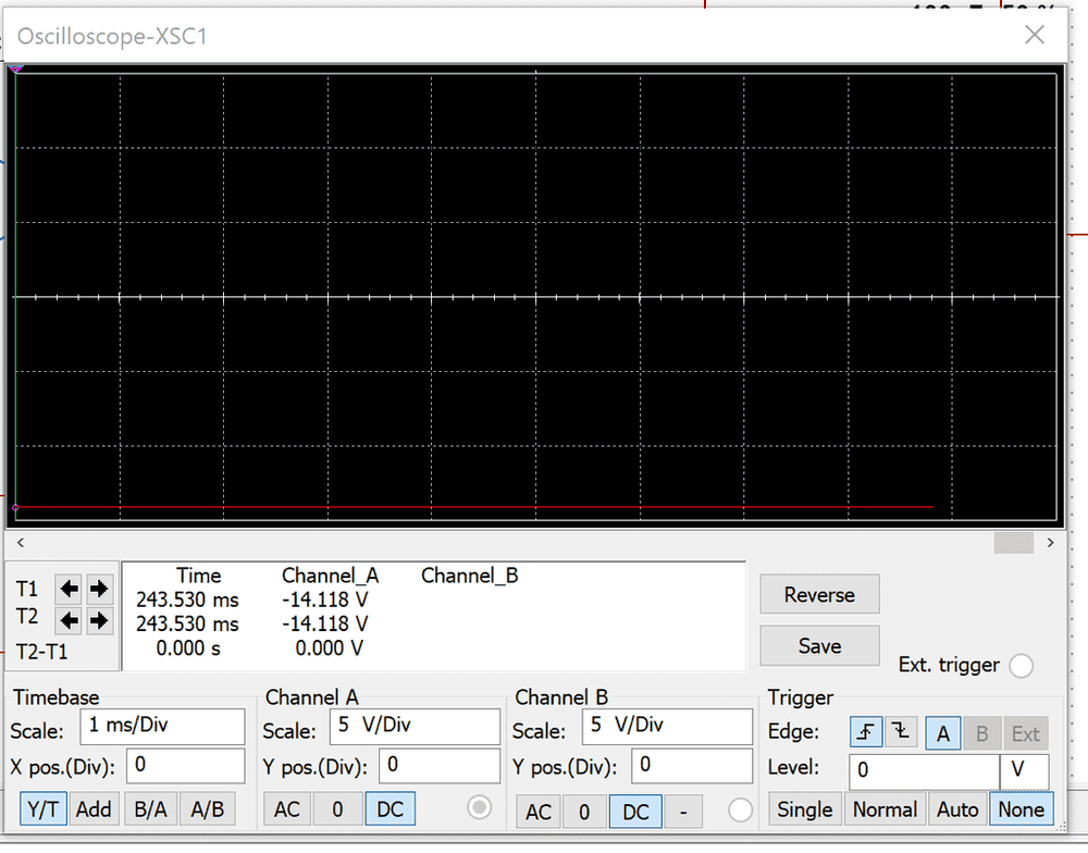

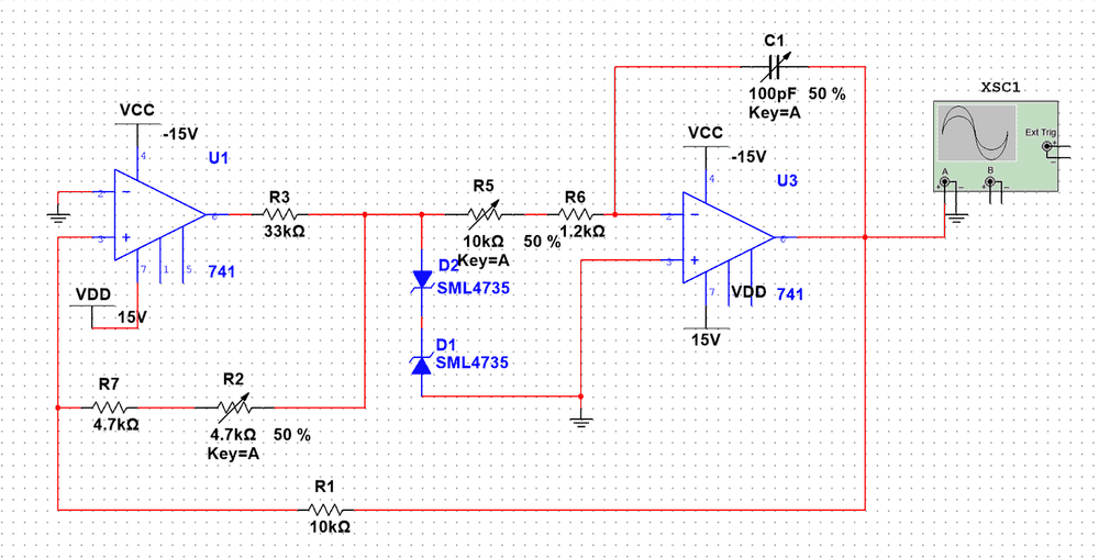

I tried to solve this question using Multisim. Here's my attempt:
That's what I got :
Kindly,could someone tell me where is my mistake ?

Does each small subsection work? I would try breaking it up into two op-amps then see if each one works with that setup.
I don't know much about the circuit setup in that software I am noticing that on the right op-amp the way the voltage rails are connected looks different from the first one. Is that okay or allowed?

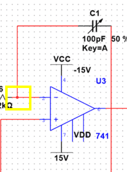

Is C1 really connected to U3-6? I don't see a dot there.
Yes, it is connected.
What's the VDD seemingly floating or is it connected to the offset? Right up against the offset pins on U3.
Earlier comment I was meaning between the left and right op-amp; not just the reference image. You assign VDD and VCC to each op-amp, but for some reason the one on the right says VCC and 15V. It's inconsistent. I suppose if the nets are equal then maybe it doesn't matter... wasn't sure.

Can you break up the two op-amps around the center put and put an input voltage source to each one; measure the output to see if you're getting what you expect? Maybe omit R1 for now.

At pin 6, the output?
No, I didn't connect the capacitor to pin 6.
Sorry for misunderstanding, I didn't read your previous question well.
It should be. Try it that way.

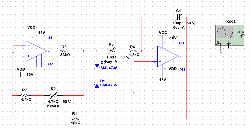

The result:
Now check that every component at that node is connected. If you make all connections a "T" intersection with a dot, then you'll know. Or verify it some other way, like the netlist for example.
I checked. C1, R1, pin6 , and channel A (oscilloscope) are connected together at the same node, but the result is the same (straight line at the origin).

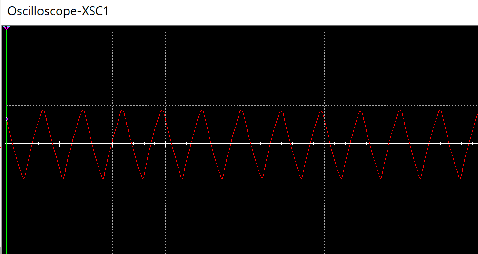

Are you sure C1 should be 100pF. My rough calculation says that the ramp of the triangle (the time it takes C1 to charge) should be about 7V/usec. That is much faster than a 741 op-amp can change it's output (slew rate is about 0.1 V/usec). Also, your oscilloscope is set in the msec range. That is an odd combination for a circuit like this. Still, I'm not sure why it wouldn't oscillate at some frequency.
Try a larger value for C1, like 0.1uF maybe.

Got it !
After changing the value of the capacitor to 0.1uF.
Thanks for your help.
