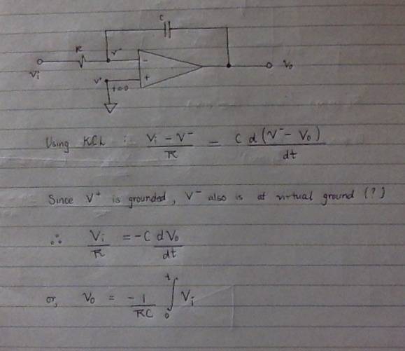

Summary:: My understanding of integrators and the waveforms they generate is hazy.
The question I am trying to solve is : Sketch the output waveform for an inverting integrator if the input signal is a square wave with amplitude 5 V and frequency 1kHz where the product of Resistance and Capacitance is 1.
I have the following questions with regard to the question, integrators and the waveforms they generate.
1. I have derived the equation relating input and output voltages however I am unable to understand exactly how the current is flowing, how the capacitor is behaving etc within the circuit...
2. I believe that the result is a triangular waveform output. However I don't really understand why :

Two rules in linear opamp operation (within the design limits of the device):
1) No current enters or leaves either opamp input.
2) Opamp inputs track each other. What voltage appears on one will appear on the other.
Now, rethink it.

Since the capacitor plate connected to the output terminal is at the same potential as the output terminal, it must thus develop the same potential (much larger than the input voltage). This seems to create a sort of 'negative feedback cycle'? My thinking is that a positive voltage input produces a large positive voltage at the output as well as developing a large positive potential on the capacitor play connected to the output. This should mean a negative potential is formed on the capacitor plate connected to the input terminal. Assuming I am correct so far, how would this negative potential affect the positive voltage signal being input?
Regarding the virtual ground issue, I am guessing the non-inverting terminal develops a positive voltage which is the same as the voltage of the inverting terminal? (the other case of both being at ground potential?!)

The non inverting terminal cannot develop a voltage when it is tied directly to ground.
In your circuit, a positive voltage on the left side of the resistor will cause an increasing negative voltage on the output in order to satisfy opamp rule #2.

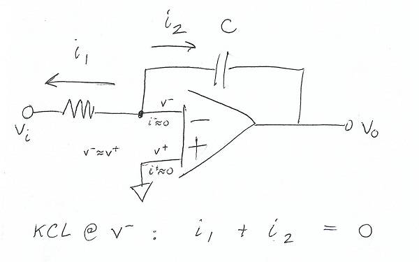

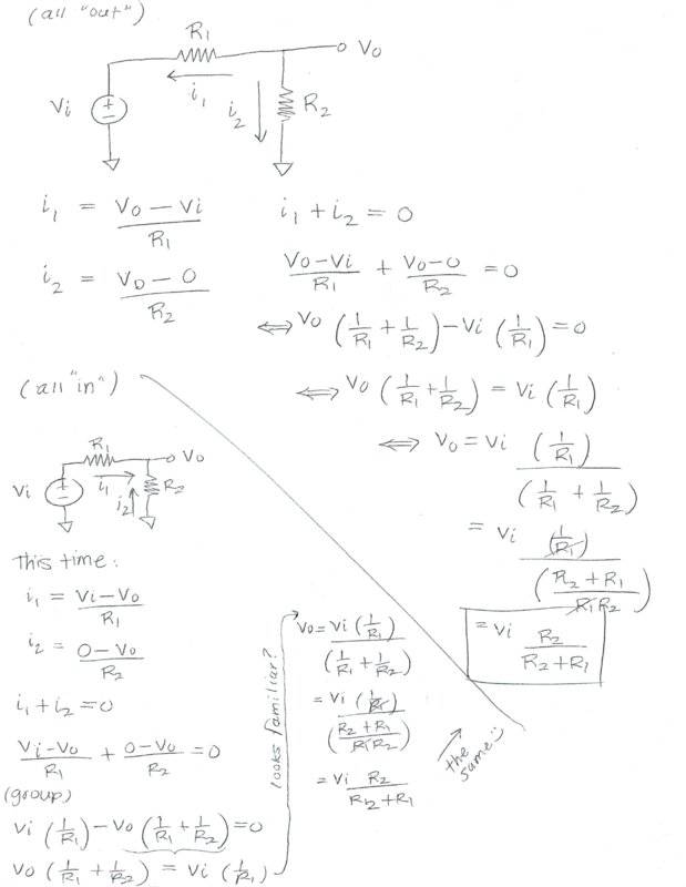

If you're curious about the currents, then why not use KCL at the node between the two elements? Keep in mind what averagesupernova (what an average name ?:) I love it) said in the earlier post #4 about the current going into the op-amp and the voltages at the two terminals.
Like this
Solve for ##i_1## and ##i_2## (Ohm's law). You'll be able to solve for your transfer function, which you've already got... you'll also know exactly what's going on with the current (I think you're more curious about ##i_2##, right?)

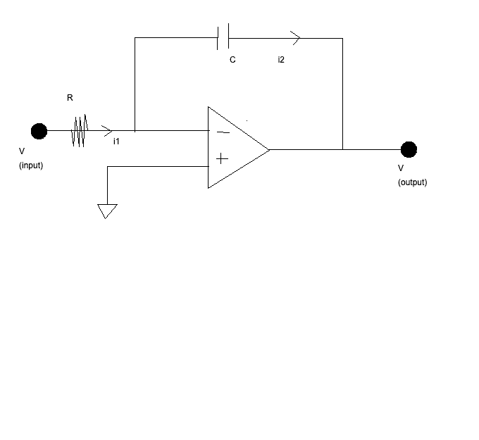

I think I understand how the integrator works theoretically (as in how the equation is arrived at).
Using the two rules for OpAmps,
a. I think that V+ and V- would be at ground potential. (But how does the amplifier amplify a null input?!)
b. Input signal ##V_i## drops across R to ##V-## which is 0?!
c. The amplifier output is the inverted integral of the input signal (according to the equation).
d. Perplexed about about how this negative potential interacts with the capacitor and how the feedback interacts with the input at the inverting terminal.
e. According to the rules, no current flows through the circuit.f. So if a square waveform is the input signal, the output would be the inverse of the integral of the square waveform. But this seems to give a constant output signal...

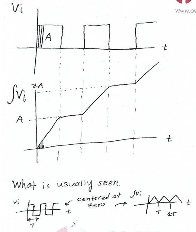

It's not a constant output.
You're setting fixed values to your boundary conditions on the integral, and so that very last graph is incorrect because you're plotting for all ##t## when what you've solved for is just for the integral at one point where ##t=0.5## [Another quick note that I would revisit the integral of 0 (it's not ##t##)]
You should set your integral to something like this (notice a subtle change in notation using ##t'## by replacing ##0.5## with ##t'##).
$$\int_0^{t'} 5\, dt + \int_{t'}^1 0\, dt$$
I would expect behaviour like this (just talking about the integral alone and ignoring the negative from your op-amp equation).
I added the What is usually seen... maybe I'm wrong-- just what I've seen in my textbooks and assumed that it was more common.
Look away from the hand calculations and formulas for a moment to recall what is the output of an integral... it's the area under the curve.
We recognize the integral under a curve is just the area of the square wave so as you move along the highs (the first one ends at ##t'##) you'll see that adding small slices (was trying to draw) up to your boundary condition increases the out (across the entire square wave the integral will be ##A##); when you move along zero you're adding nothing. The amplitude of your square wave has no negative values, and so you're not going to add any negatives (just like the part I drew in I thought was normally seen).
In real life it could eventually become a constant output, but this is normally not intentional... the op-amps have a supply (rail) and so when the amplitude of the output gets near the rail (usually a few mV below will do the trick) it saturates and won't go any higher- for example it wouldn't make any sense to expect a 5V output when the op-amp is only supplied 3V.

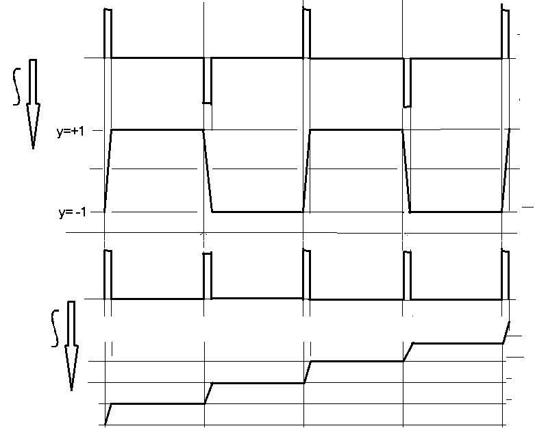

JC2000 said:
Regarding the square wave to triangle wave conversion :
I broke one cycle of the square waveform into functions (essentially the horizontal lines OK corresponding to 'constant peaks' ?? on either side).
However integrating these two horizontal lines (say## y = x## and ##y = -x##) Or preferably, don't say that! gives me two functions (##y = (x^2)/2## and ##y = -(x^2)/2##) which are vertical parabolas...

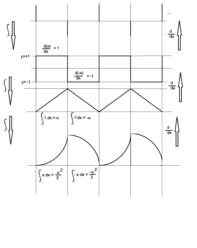

This is where you go wrong. The top of the square wave is## y=A ## and the bottom is ##y=-A##
When you integrate, you get ##y= Ax \text{ and } y= -Ax \, ## which are both straight lines, making your triangle wave.
Now, as for your staircase (I forgot you'd asked this when I drew the piccy)
If you look at the differential of the square wave, you see a series of pulses of alternating polarity.
These pulses are interesting beasts, invented, I believe, by Paul Dirac as the delta function. Ideally they have zero width (!) and indeterminate amplitude, but their integral is 1 ( or A if the basic pulse is multiplied by A)
If they sound a bit impossible, that's because you never actually get square waves that change from -1 to +1 in zero time. A square wave is equally imaginary - this time I think imagined by Oliver Heaviside as an extension of his step function.
So in practice we get an approximate square wave by integrating a series of finite positive and negative pulses. The width of the pulse limits the rise time of the square wave, because, asyou know, integrating a pulse (like the blocks of a square wave) gives you a straight slope. So integrating a series of alternating, very short pulses will give you a trapezium wave - long pulses with sawtooth sides. (Diagram to follow)
Anyhow, that leads to the simple answer to your staircase: integrate a series of pulses (ideally delta pulses) of the same polarity. Each pulse causes a new half cycle of a square wave, but always in the same direction.
That's all on paper. You are limited by the response of your integrator and by the size of the pulses you can generate. But everyone else has flogged that horse to death and it should be fairly easy to get decent results up to anything you can see on your average oscilloscope.
A bit rushed, but I hope it shows enough. I had to squash the staircase a bit, as I ran out of screen!
Like this
Did you assign some directions for ##i_1## and ##i_2## or are they obvious somehow?!
When applying KCL would it be ##V_i - V^{-}## or the reverse?
It doesn't matter which direction you assign them. The math will correct the answer. If you draw them the "wrong" way, then you'll get a negative current (for example if it's -100 mA when you drew the arrow left, then you know it's 100 mA going right, the problem is solved and both are valid answers). What I like to do is draw all the currents in the same direction either all in or all out and the sum of them add up to zero. If you don't draw them all the same direction, then you have to do very careful bookkeeping of the sign.
I would expect for you to find one of my old posts in a different thread, but I draw it out for someone and show them a voltage divider example. Maybe it'll be helpful for you.

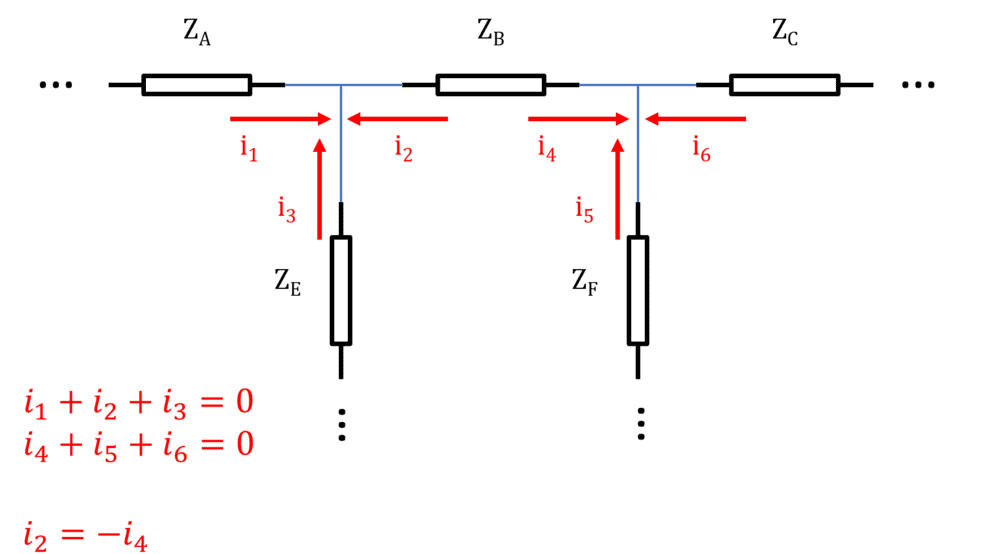

Joshy said:
My personal preference is to make them all face the same direction ie. all inward or all outward. I don't have to worry about any bookkeeping and I'll let the mathematics dictate the direction.
Something like this:
Here's an example with a classic Voltage Divider. I know it's simple, but the point is to show that the direction didn't matter.

"So if one input is grounded and we are providing the other input then as the grounded input can never be a non zero value, the other input will always be zero (because of virtual grounding)?"
You may be reading too much into that 'rule.' An ideal OP-AMP will drive the output positive when the non-inverting input is more positive than the inverting input (and negative when the opposite is true). the 'virtual ground' behavior is the result of properly selected/arranged external components.
