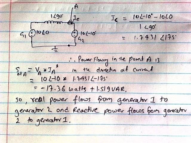

I was reading about synchronizing of two AC generator. As an aid to grasp the concept, I tried to analyze what will happen if two generators of same frequency and voltage but slightly different phases were paralled.
I am slightly surprised to find out that active power flows in there even if there appears no resistive Loads. And that the direction of active power flow is governed by which generator lag in phase.
Also, I asked the question, why should the Generator 1 Provide power (real) to generator 2 simply because its phase is leading? Is this a natural duty for leading to power the Lagging?
It seemed quite asymmetric to me.
Of course maths have the answer. So, after trailing back calculation, I convinced myself that the asymmetry comes from the fact that in between the generators lies an inductive reactance as opposed to capacitive reactance.
I am looking for practical cases of what the active power and reactive power does in there? Does it help to make the phase equal? How?
Thanks.
So real power flows from G1 to G2 and reactive power flows from G2 to G1
Be careful about that second statement, it's not true (despite your calculations being correct).
What your calculations show is that G2 is supplying -17.36 Watts and also supplying +1.52 VAR (so absorbing real power and supplying VAR).
The above is correct. Further, it is correct to assume that the power absorbed by G2 is being supplied by G1, so G1 is therefore supplying 17.36 Watts.
It is however incorrect to assume that the reactive power being supplied by G2 is being absorbed by G1. If you do the calculations at G1 you will find that in fact both G1 and G2 are supplying reactive power.
Q. Where is the reactive power going?
A. To supply the reactive power absorbed by the inductor. (BTW. Inductors absorb reactive power and capacitors generate it).

I did calculation as you suggested. You are correct. Reactive Power is negative across G1. So, the inductor seems to consume reactive power from G1's side too.
But I am confused here. Is the inductor consuming 2*1.519 Var or just 1.519 Var. Are we finding same power from two sides or there are two powers? Seems simple enough but still confusing.

And for the OP, what do the active power do? Does it help bring G2 in phase with G1 since G2 will be in motoring mode (OR actually in Less-Generating mode?). Some insightful lecture is expected. :)
Yep it is 2 times 1.519 var being consumed by the inductor.
Yes, it's fairly easy to show that if [itex]\theta[/itex] is the phase difference between the two generators (and V1,V2 the rms voltages) that the real power flow is,
[tex]P = \frac{V_1 V_2 \sin(\theta)}{X_L}[/tex]
And that the direction of power flow is from the generator with the relatively leading angle to the one with the relatively lagging angle.
In terms of the machine dynamics, this direction of power flow tends to try to slow the leading generator (causing it's angle to retard) and to speed up the lagging generator (causing it's angle to advance).
So, in our example, the Two generators are likely to get stabilized at voltage of 10<-5 (10 angle 5 degree) ,

The generator converts engine power into electricity just as the mower blade converts engine power into shredded grass.
Frequency is speed which is set by the governor, not the generator or blade.
Good Questions, I M L...
This is the age of technology, so enjoy it. Take things apart and figure out how they work.
I was never smart enough to remember a lot of equations but found if i could figure out how something worked the formulas came naturally enough from basic physics.
