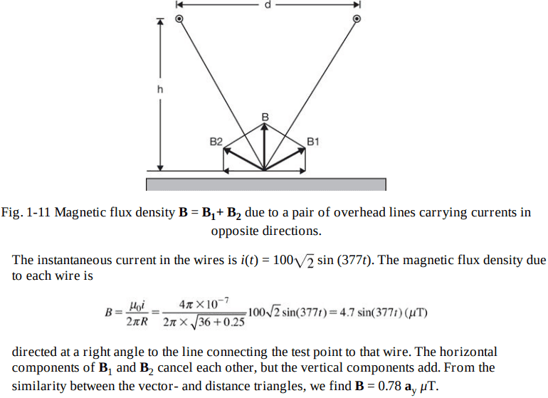

Two infinitely long parallel wires separated by 1 m are at 6 m above ground. Each carries a 60-Hz AC current of 100 amperes (rms), but in opposing directions. Find the magnetic flux density B at a test location on the ground which is at an equal distance from the wires.
B = u*i/(2*pi*R)
Diagram of two overhead wires carrying currents in opposite directions, height h above a ground line, separation d, with field vectors B1 and B2 from each wire and their resultant B pointing vertically upward.
I got 4.7*sin(377t) micro-Tesla for each wire, but where are they getting the total B-field equaling 0.78 micro-Tesla?
Is it some hidden trigonometry?

Did you calculate the vertical component of B1? You can use similar triangles as suggested in the solution.

You have d and h. What other dimensions do you think you need to know? Each B field vector is perpendicular to its corresponding radius vector.

I guess I don't understand what you think is missing. You've calculated the magnitude of the B field vectors, and you know their directions. Do you know how to do vector addition?

You need to go back and learn how to do vector addition, otherwise there is no hope of solving problems like this. Basically, each component of the two vectors needs to be added independently.

As it says in the problem statement, you have two vectors, and the resultant magnetic field is the sum of the two (B = B1 + B2). B1 is the magnetic field due to wire 1, and B2 is the magnetic field due to wire 2. The total field is the vector sum of these 2, since Maxwell's equations are linear. Can you write out B1 and B2 in vector form?
By vector form, I mean like this:
[tex]\vec{B1} = B1_x \vec{e_x} + B1_y \vec{e_y}[/tex] [tex]\vec{B2} = B2_x \vec{e_x} + B2_y \vec{e_y}[/tex]
