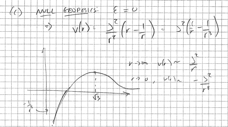

Q1)for part c)
##V(r) = ( \frac{J^2}{r^2})(r-\frac{1}{r}) ##
I am able to deduce the shape of the curve from the fact that the potential ##V'(r)=0 ## is a quadratic and solveable, and so i can check whether this is a stable or unstable point. So to sketch I:
a) ## \lim r \to \infty ## and ## \lim r\to 0 ##
b) to deduce the cts shape consider the critical point and check whether it is stable or unstable.
and that gives me the following which is fine.
(giving me the following:
Handwritten working on grid paper: null geodesics case epsilon = 0 with V(r) = (J^2/r^2)(r - 1/r), limits as r to infinity and r to 0, and a sketch of V(r) rising to a maximum at sqrt(3) then falling.

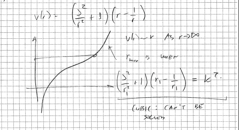

however for part d) instead we have ##V(r) = ( \frac{J^2}{r^2}+1)(r-\frac{1}{r}) ## and now ##\lim r \to \infty = r ## but ##\lim r \to 0 = -1/r^3 ##. from this I can draw the start and end , but am unsure how to connect in the middle- curving upward or downward. compared to the above, null example, where the critical point is solvable and i can check stability to deduce the shape, here the critical point is unsolvable so I am unsure how to do this.
I have the following so far:
Handwritten sketch: V(r) = (J²/r² + 1)(r - 1/r), a graph of V against r with axes, a curve rising steeply to the right, and text noting V ~ r as r tends to infinity, r_max, and that the cubic cannot be solved.
the answer is:
Handwritten sketch of an effective potential V(r) = (J^2/r^2 + 1)(r - 1/r) on grid paper, with a curve rising from the lower left to the upper right and an annotation that V(r) ~ r as r tends to infinity; the r_max region is marked and the cubic equation is noted as unsolvable.
I AM UNSURE WHY, how to deduce the shape on the 'jointy' bit.

  • Handwritten sketch of an effective potential V(r) = (J^2/r^2 + 1)(r - 1/r) on grid paper, with a curve rising from the lower left to the upper right and an annotation that V(r) ~ r as r tends to infinity; the r_max region is marked and the cubic equation is noted as unsolvable.
