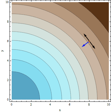

See if this contour plot of [itex]A(x,y)[/itex] helps. The blue vector represents the unit vector pointed in the direction of [itex]\vec{\nabla}A(x,y)[/itex]. The black vectors represent unit vectors in the direction of no ascent - they correspond to each [itex]\hat{r}[/itex] you need to find.

alfredska said:
Is this less ambiguous?
Yes. It is less ambiguous, but still I am confused.
