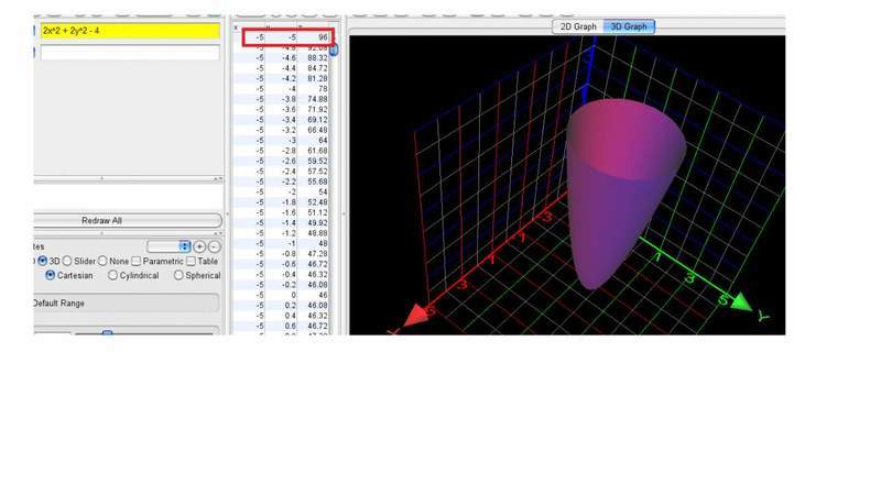

Another question... the 3d picture is on the paint doc and I am wondering why the entire surface is only in the first octant because isn't the point (which I hightligted in the paint document) in the 3rd octant?
  • Screenshot of a 3D graphing program showing a surface plotted in a Cartesian coordinate system with red x-axis, green y-axis and blue z-axis, with a table of computed values beside it. The cone-like surface sits in the positive region, and a red box highlights the first row of values.
That graph is screwy.
The graph of the equation z = 2x2 + 2y2 - 4 is a paraboloid that opens up from its vertex at (0, 0, -4), and whose central axis lies along the z-axis. In your picture, the thing appears to be in the first octant.
It isn't in the first octant. It is correct. The planes that look like the coordinate planes aren't ##x=0## and ##y=0##. Look how the axes are labeled.
Good point. I saw how the axes are labeled, but I didn't notice that the planes you see aren't the regular coordinate planes.
