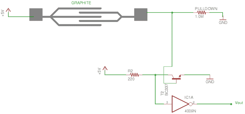

graphite has high conductivity , so i though of making a touch button out of a pencil drawn pattern on the wall.the pattern is shown below.
when not touched -resistance between ends of the pattern >200Mohm (exceeds dmm limit)
when fully pressed - resistance between ends of the pattern = 1.3 Mohm.
but Vout rises after delay or falls after delay of some 100 ms.due to high impedance
this pattern connects skin resistances in parallel
can someone suggest a better pattern ( of lower end to end resistance) ?
for faster response
Hi hackhard. You probably have the transistor drawn incorrectly on your schematic.
I like your experimental bent, but a problem with a graphite pattern is that it will sooner or later probably smudge and establish a bridge between the tracks.

thanks for help. I've decided to use conductive ink
conducting paint is too expensive.
are there any other alternatives to copper foil strips or Bare conducting paint
