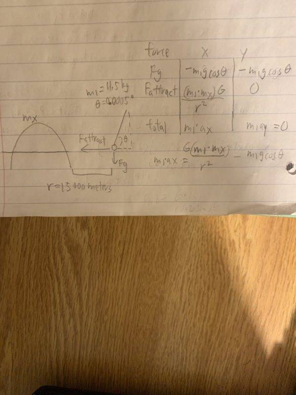

Directions x and y are meaningless without a diagram. Please show and post a diagram showing all the forces acting on the ball and label them appropriately. Write equations derived from that diagram. Don't forget that you need to introduce the unknown mass of the mountain. The equations in post #3 are independent of it.
I got up to m(ax) =m1(mx)(G)/(r^2)-m1(g)cos(0.0005)
Is the ball suspended in mid air with only the two gravitational forces acting on it?
The question doesn't specify but I think when it said 'hang vertically' it means it's in midair. I can't solve for (mx) without knowing the acceleration (ax).
ac7597 said:
When they are still a distance 15000 meters away from the mountain, they make a local gravitational force measurement: they hang a ball of mass 11.5 kg from a string. The string doesn't hang vertically, but tilts very slightly towards the mountain. Dixon estimates the angle to be 0.00050 degrees.
What about the string?
assume string is massless
That's not what @kuruman was asking. Isn't the string attached to the mass? Is the string slack?
String is not slack. Is the body diagram correct?
The free body diagram is not correct. If the string is not slack, it follows that it must be under tension. This tension acts on the ball. Add it to your diagram. Also, the acceleration of the ball is zero; the ball just hangs there motionless at the given very small angle relative to the vertical. Should you require more help, please post your revised diagram and a complete revised attempt at a solution.

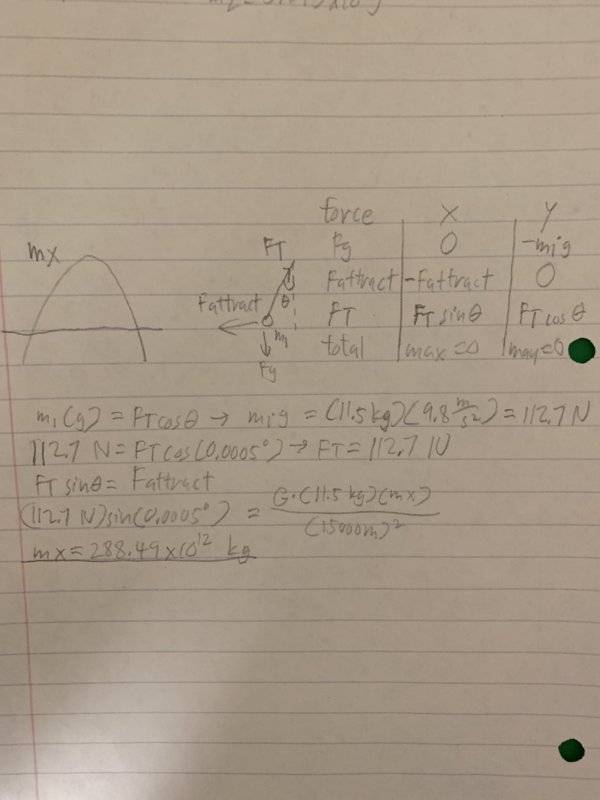

Is this the answer for part 1?
Please re-read post #13 and post #14
The thumbnail sketch in the middle looks right, but it should be several times as large.
You don't need to show the mountain in an FBD of the bob, just the force it exerts.
None of the rest belongs in an image. Per forum rules, please take the trouble to type in your working. Not only does that make it much easier to read, it is also easier to comment on specific steps.
