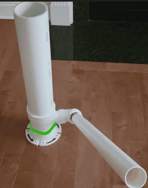

TL;DR Summary: Hi, I am a high schooler competing in a science competition building a trajectory to shoot the projectile similar to the one in the thread below.
https://www.physicsforums.com/threa...launch-projectile-science-competition.773745/
The 4 inch drop tower is connected to the 1.5 inch pvc that shoots the ping pong ball projectile. I am dropping a mass of 2.5 kg weight in to the drop tower that acts as the piston. The goal of the competition is for the projectile to land anywhere between 2 and 8 meters. No matter what the mass of the piston or air tight it is in the drop tower , my projectile is not launching past 5m. i am able to launch the ball to the same distance using a 3d printed weight (around 120 gms). So basically having heavier mass is not doing anything. I am at a loss as no matter what i tried or changed i can't seem to go past 5m. Please help on what i am doing wrong,

Hi Hutchphd, please excuse my illustration. I placed a wood block at the bottom where the mass falls, so it wouldn't hit the floor (highlighted in blue in the attached picture). The weight(highlighted in red) falls exactly near the elbow and covers the hole of the elbow by 3/4 once it is at the bottom. Both the light and heavy mass are identical in height and falls to the exact position
My suggestions to reduce air leaks as much as possible:
Seal well between the base of the column and the floor.
Use Teflon tape to seal all the threaded couplings, even the one that pivots to adjust the launching angle.
Make several grooves around the perimeter of the piston, in order to create a labyrinthic seal that reduces the volume of air that escapes while the piston drops. make a chamfer at the edges. Make the piston as tall as possible.
Please, see:
http://docs.codecalculation.com/mechanical/seals/labyrinth-leakage.html

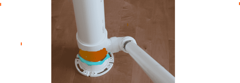

Hi Lnewqban, Thanks you so much for responding. I sealed the joints of the barrel and the drop tower with the pvc cement so there are no air leaks. i guess this is where I am getting confused on what it can be. How can I get the labyrinth seal on a lead puck?
What about the seal between the base of the column and the floor?
How did you make the puck?
Do the rules give you liberty to change the lengths of both pipes?
The only rule in regards to the height is the whole device has to fit in 75 x 75 cm cube. I purchased the lead puck that weighs 5 lbs and 3.5 inch in diameter. I used the tape to make it as air tight as possible to match the diameter of the 4 inch drop tower. I put the 4 inch drop tower pipe on a 4 inch tee and put a wooden block (highligted in green) on the top of the tee just under the elbow to seal the pipe and the floor. So basically everything is air tight
Then, as the internal diameter of a schedule 40 4-inch PVC pipe is 101.5 mm, you had to build up the radius of the puck with 6 mm of tape around its perimeter.
The height of the puck should be around 1-1/4 inch.
I would use two or three narrower strips of tape to create the seal.
Perhaps the puck is not perfectly cylindrical and air leaks between it and the 4-inch pipe.
Could you test the time descending while the small pipe is capped and compare it to the time of normal operation?

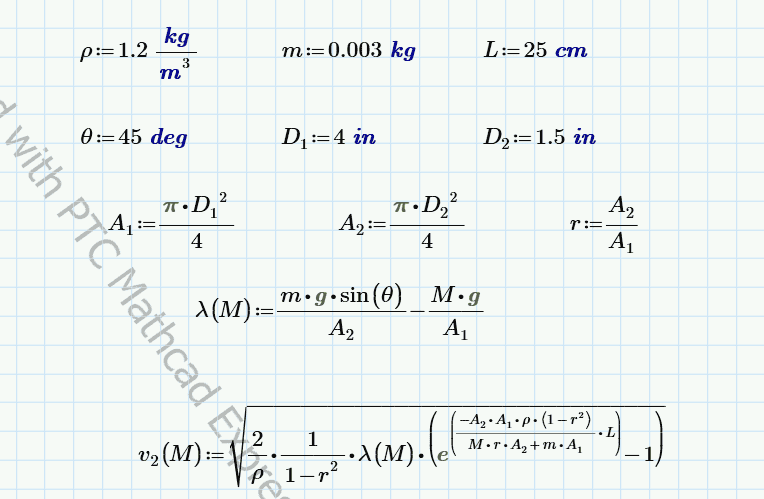

So, since this is beyond the scope of the high school analysis, (without the holes, and neglecting compressibility effects) If you solve the system of equations in #11 you get the following ODE w.r.t. the coordinate of the projectile ##x_2##:
$$ - \left( \frac{M r A_2+m A_1}{A_1A_2} \right) \frac{dv_2}{d x_2} v_2 = \frac{\rho}{2}\left(1-r^2 \right)v_2^2 + \lambda \tag{1} $$
Where
##M## is the mass of the piston
##m## is the mass of the projectile
##r## is the ratio of areas ## \frac{A_2}{A_1}##
## \rho## is the density of air
and
##\lambda = \frac{mg \sin \theta}{A_2}- \frac{Mg}{A_1}## ( a constant parameterized by ##M##)
##\theta## is the angle the barrel makes with horizontal.
The solution to (1) is given by:
$$ v_2 = \sqrt{ \frac{2}{\rho} \frac{1}{1-r^2} \lambda \left( e^{ \frac{-A_1 A_2 \rho ( 1-r^2) }{M r A_2+m A_1} L} - 1 \right) } $$
Where ##L## is the length of the barrel.
Here is a plot of ##v_2## vs. ##M## for what I thought are reasonable parameters:
That horizontal asymptote is found via the relationship @hutchphd showed.

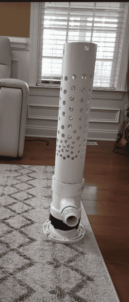

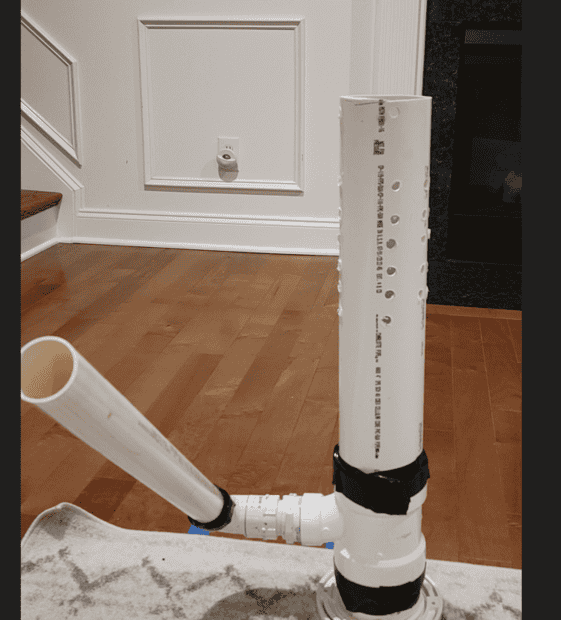

I drilled the holes and now the ball shoots around 5.5 meters. Do I need to drill more holes?
How far down the pipe and how many holes did you drill? A picture of updates would be good.
Sorry, I tried uploading the video and it is too big.. I drilled 30 holes all around the tube. and above 12 inches from where the weight drops to the bottom
just a picture would be fine.
Well, 30 sounds like a good bit. What diameter? Just make sure you save enough sealed volume above the barrel port to fully displace a barrel volume with the piston. Can you calculate how high the holes should start above the barrel port? Below that would probably be detrimental to performance. I would still go toward there in stages, even after the computation.
Also, make sure you have de-burred the holes if you haven’t done so already.

Hi @erobz,@hutchphd , I am totally lost. No matter what i did, sanded smooth inside, added lubrication, changed the angle of the barrel, I am not able to shoot past 6 meters now. This is how it looks now before attaching the barrel. You think this design may not work for what I am trying to achieve?

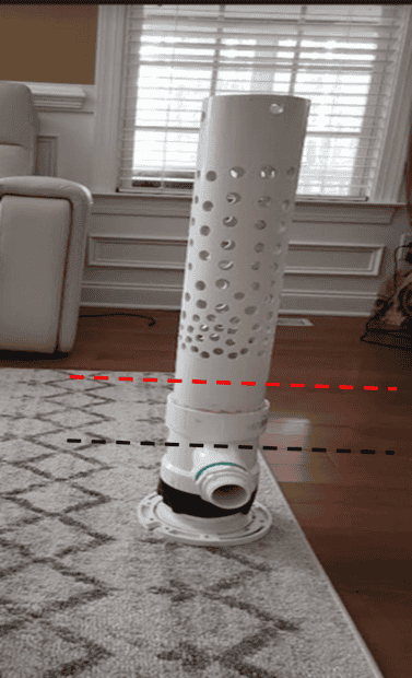

But you have in fact improved the range, correct? Have you calculated the internal working volume of the barrel to determine how much of the tower must not have holes in it above the top of the barrel port?
Hi @ erobz ,
The total volume of the barrel is 301.59 cubic inches ( 24 inches height and 4 inch diameter)
The sealed chamber is 9 inches down from where the holes to the top of the weight when it is dropped , so if I am calculating correctly, my internal working volume is 113.10 cubic inches
You need data to determine what is going on. I suggest firing the ball straight up for tests (one less variable to worry about). Measure (video against a marked board?) the max height of of the ball for the two different weights at five different drop altitudes. Record the results and send them along with analysis (maybe a graph)?. We can probably help.
The difference between "doing science" and "playing" is that for science you quantify and record all results!......
Also how high does the ball need to go in these tests to get the range you need when you tilt the barrel? You should be able to calculate this (ignoring air resistance)
