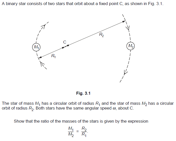

Diagram of a binary star system with masses M1 and M2 on dashed circular orbits about a fixed point C, with radii R1 and R2 marked from C to each star.
the solution says to equate the moments about C or equate the centripetal forces
but the moments, they used M1R1 = M2R2
how does the above represent the moment, and why is the moment even equal?similarly, why is the centripetal force equal?
thanks in advance

Alright. Write it down for each of the stars. Is it the same both? Is it different for each?
For the stars to be moving in circles, this force, acting on each of the stars separately, has to be equal to the centripetal force. Write down the centripetal force equation for each star. Are they the same? Are they different?
Next, for each star, equate the actual (applied) force that's acting on it (gravity), with the force (resultant) required to be moving in circles. You'll end up with two sets of equations. See if you can do any algebraic magic on them.

the gravitational force is the same. i understood the thing about centriptal force. thanks.
The solution is already available, i just wanted to understand it.but one thing i have not yet understood - why are the moment equal? why did they use to equation i stated at first? is this a simplification of something else, or is it a formula itself?

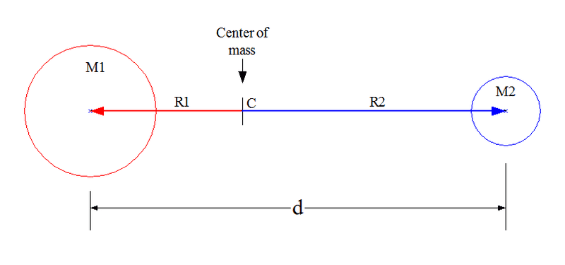

Where is the mass centre of the system in relation to C?
sorry, i don't know about this one. i assume it is at a radius r from C, but i think that this centre also moves.

"The system" is both stars taken together. There is no external force on that system, so the mass centre of that system cannot accelerate. ##\Sigma F_{ext} = ma##.
C in the diagram is defined as a fixed point. I'm endeavouring to prove to you that it is the mass centre of the system. M1R1 = M2R2 would follow immediately from that by definition of mass centre.

so, when the centre is fixed at C, we can write M1R1 = M2R2. how does this formula come? is it an actual formula, for example momentum = mv?
If you follow the steps I outlined earlier, you should arrive at the equation provided.
It comes from the definition of the center of mass.
