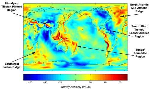

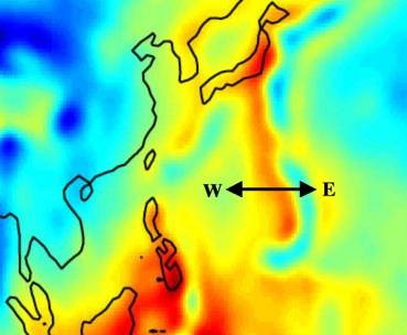

__________________________________________________An alternative to using spherical harmonics coefficients is to use a gravity anomaly map. This map of the Izu-Bonin-Mariana arc region is based on GRACE data rather than GOCE, so not quite so much resolution as GOCE should yield:
The Mariana Trench is that bluish arc at the east end of the west-east arrow. The blue represents a negative gravity anomaly. One can also see positive gravity anomalies in the forearc to the east (yellow) and backarc to the west (red). The color scale is the same as that on this map:
The gravity anomaly in these maps is the deviation in mGals (10-5 m/s2; 1 mGal = one milligalileo, and a galileo is one centimeter per second squared) from that due to an ideal oblate spheroid model of the Earth,
