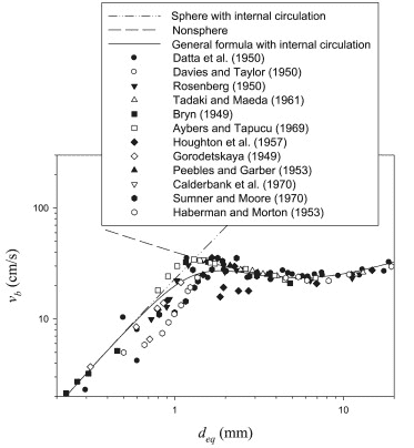

As from the paper I linked to, it seems that the terminal velocity doesn't change much over the range of diameters from 1 to 20mm (and possibly a bit beyond):

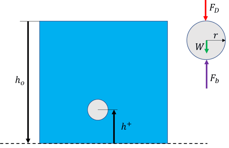

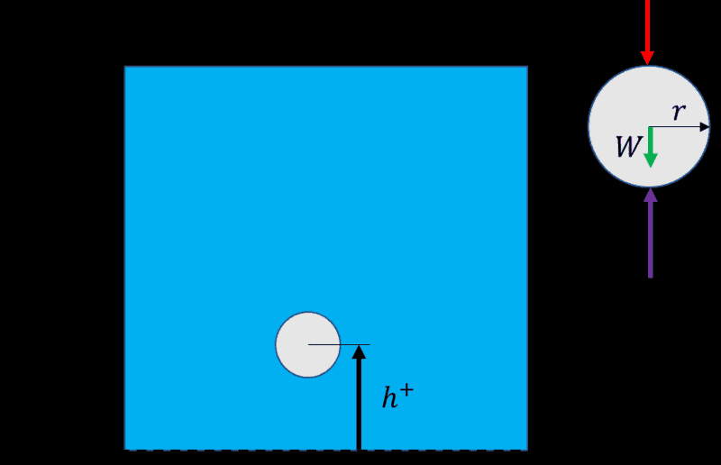

We can try to make a model with some basic (narrowly applicable) assumptions:
  1. Bubble is Ideal Gas
  2. Isothermal expansion of the bubble as it rises
  3. The bubble remains spherical
  4. Quadratic Drag
  5. Pressure inside the bubble is equivalent to outside the bubble
  6. Neglecting pressure gradient across bubble as it expands
Newtons Second Law:
$$ F_b - W - F_D = m \ddot h \tag{Eq 1}$$
For the buoyant force:
$$ F_b = \rho g V$$
Using the Ideal Gas Law (assumption 1) (isothermal expansion) to find the volume of the bubble:
$$ P_{abs} = \frac{mRT}{V} $$
Equate that to the absolute hydrostatic pressure in the fluid at depth ##h_o -h## (assumption 5):
$$ \frac{mRT}{V} = \rho g (h_o - h) + P_{atm} \implies V = \frac{mRT}{\rho g (h_o - h) + P_{atm} }$$
Substitute:
$$ F_b = \rho g V = \rho g \frac{mRT}{\rho g (h_o - h) + P_{atm} }$$
Force of weight:
$$W = mg$$
Force of Drag:
$$F_D = \frac{1}{2} C \rho \pi r^2 \dot h ^2$$
The cross-sectional area of the bubble will ultimately be a function of the depth, through the volume of the bubble ##V## and spherical bubble (assumption 3):
$$\frac{4}{3}\pi r^3 = V = \frac{mRT}{\rho g (h_o - h) + P_{atm} }$$
This implies that:
$$ r^2 = \left( \frac{3mRT}{4 \pi} \right)^{2/3} \left( \rho g (h_o - h) + P_{atm} \right)^{-2/3}$$
Now just make the following substitutions:
$$ \lambda = \rho g (h_o - h) + P_{atm}$$
$$ \implies \dot h^2 = \left( \frac{1}{\rho g} \right)^2 \dot \lambda^2$$
$$ \implies \ddot h =\frac{-1}{\rho g} \ddot \lambda$$
Making all the substitutions into ##( \rm{Eq 1})##:
$$ \frac{m}{\rho g} \ddot \lambda + \rho g m R T \lambda^{-1} -mg - \frac{1}{2} C \frac{\pi}{\rho g^2} \left( \frac{3mRT}{4 \pi} \right)^{2/3} \lambda^{-2/3} \dot \lambda^2 = 0$$That’s at least half the battle. Then just decide on some parameters, initial conditions and solve (numerically) the non-linear, second order ODE.
