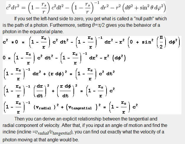

giving r = 3m for a photon traveling in a perfectly circular orbit. As far as photons go, as a photon falls toward a body, it spirals inward. If it doesn't pass a tangent point, it will fall all the way in. If it passes a tangent point, however, then it will spiral back out and eventually escape. It cannot turn around to spiral back in again because that would require that it passes another tangent point at a greater radius than the first, so angular momentum wouldn't be conserved. So other than a perfectly circular orbit at r = 3m, which would require that it be "born" there, and so precise with no disturbances as to make it virtually impossible, these are really the only two options for photons.

Geesh. All I really needed to show that ds = c dτ, without any reference to energy, is
v'^2 = v_r'^2 + v_r'^2
for the locally measured radial and tangent speed of a freefaller with scalar speed v', which transforms to
v'^2 = (dr' / dt')^2 + (dθ' r' / dt')^2
v'^2 dt'^2 = dr'^2 + dθ'^2 r'^2
c^2 dt'^2 - [v'^2 dt'^2] = c^2 dt'^2 - [dr'^2 + dθ'^2 r'^2]
c^2 (1 - (v'/c)^2) dt'^2 = c^2 dt'^2 - dr'^2 - dθ'^2 r'^2
where dτ = sqrt(1 - (v'/c)^2) dt' as the clock of the freefaller is observed locally, so
c^2 dτ^2 = c^2 dt'^2 - dr'^2 - dθ'^2 r'^2
ds^2 = c^2 dτ^2 = c^2 dt'^2 - dr'^2 - dθ'^2 r'^2 = c^2 dt^2 (1 - 2 m / r) - dr^2 / (1 - 2 m / r) - dθ^2 r^2
