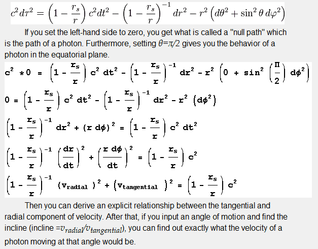

A null geodesic in Schwarzschild is given by
0 = (1 - 2m/r)-1(dr/ds)2 + r2(dφ/ds)2 - (1 - 2m/r)(dt/ds)2
where s is an affine parameter. There are two immediate first integrals,
L ≡ r2(dφ/ds)
E ≡ (1 - 2m/r)(dt/ds)
We choose to scale s so that s → t as r → ∞. This determines the value of E = 1. The orbit equation then reduces to
(dr/ds)2 = 1 - (L2/r2)(1 - 2m/r)
(dr/dφ)2 = (dr/ds)2/(dφ/ds)2 = r4/L2 - r2(1 - 2m/r)
Let r = b be the perihelion, the place where dr/ds = 0. This determines L:
L2 = b2/(1 - 2m/b)
and the final form of the orbit equation:
(dr/dφ)2 = (r4/b2)(1 - 2m/b) - r2(1 - 2m/r) ≡ f(r)
This is exact. The only thing that remains is to approximate m/b << 1 and integrate:
Δφ = ∫dr/√f(r) ≈ ∫dr/(r√(r2/b2 - 1)) + m ∫dr(r3/b3 - 1)/r2(r2/b2 - 1)3/2)
The first integral is easy, while the second one takes an integral table or computer. But the result is the correct one:
Δφ = π + 4m/b

Well, I have compared the results, that between using the metric as you gave and using the equivalence principle as I was trying to do, and the difference is astounding. I certainly didn't expect to see the results I am seeing when using the metric, since it doesn't appear to leave room for the principle of equivalence to apply at all. Of course, please verify these results and make sure that I have performed it correctly. It is always possible and even likely in this case that I have missed something.
Okay, so I wasn't sure at first at what point I could compare the curvature, speed, and direction of travel between the two methods, especially if each give completely different results, but there is one place where everyone can agree what is taking place. That is at the point of closest approach. At that point, the photon is traveling perfectly perpendicular to the gravitating body with a speed of c as measured by the local hovering observer and a coordinate speed of sqrt(1 - 2 m / b) c as measured by the distant observer. The latter is according to the metric, and we will apply the metric all the way here to see what it gives.
So using the metric and starting at the point of closest approach b, the distant observer will measure the photon to be traveling perpendicular to the body with a speed of sqrt(1 - 2 m / b) c. After some infinitesimal time, the photon will be at a distance r = b + dr from the body. Using the integration you gave, the change in angle of its position will be
ψ = (∏ / 2) - atan(b / sqrt(r^2 - b^2)) + m sqrt(r^2 / b^2 - 1) (1 / (r + b) + 1 / r)
Its original coordinates were x1 = 0, y1 = b, while its new coordinates are x2 = sin(ψ) r, y2 = cos(ψ) r. With infinitesimal distance dr, the tangent speed won't change much, so the time of travel can be approximately found with dt = x2 / (c sqrt(1 - 2 m / b)). For what I want to find for, we will also need the change in position along y, where dy = b - y2.

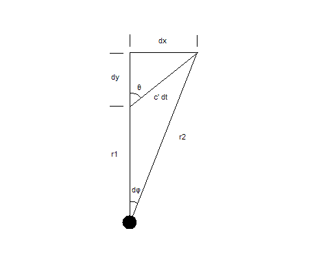

Okay, so for a photon traveling tangent to the body for an infinitesimal amount of time, with zero radial speed initially, its coordinate acceleration along the y-axis is a_y = 2 dy / dt^2. Running the actual numbers for this in a computer program, given m = G M / c^2, b, and dr close to that for the sun but rounded off so we can find the related equations better, and finding for dt and dy as described above, we get
Code:
  m          b            dr               dt                    dy
10^3       10^10       10^(-20)      4.71731*10^(-14)     3.000000225*10^(-27)
10^3       10^10       2*10^(-20)    6.67128*10^(-14)     6.00000045*10^(-27)
10^3       2*10^10     10^(-20)      6.67128*10^(-14)     1.500000563*10^(-27)
2*10^3     10^10       10^(-20)      4.71731*10^(-14)     6.0000009*10^(-27)
To first order, that is just
dt = sqrt(2 dr b) / c and dy = 3 dr m / b, giving
a_y = 2 dy / dt^2
= 2 (3 dr m / b) / (2 dr b / c^2)
= 3 m c^2 / b^2
Second order can be found by applying (1 - 2 m / b) ^ n, which works out to n = 17 / 8 using the dt = x / (c sqrt(1 - 2 m / b)) approximation, which drops it from a margin of error of 1 part in a million to 1 part in a million million for dt and dy using
dt = (sqrt(2 dr b) / c) / (1 - 2 m / b)^(5 / 4) and dy = (3 dr m / b) / (1 - 2 m / b)^(3 / 8)
although again, only for that particular approximation. I also tried it a couple of other ways, transforming to the perspective of the hovering observer, for instance, and the exponents will change somewhat, but remains the same to first order as measured by both the hovering observer and the distant observer for small m / b, with a coordinate acceleration along the y-axis of a_y = 3 m c^2 / b^2, 3 times the Newtonian value.

I'm glad I already had that worked out. :) Okay, so below is an image of the path a photon will travel in relation to the angle and radius. Over infinitesimal amounts of time and distance, the path can be considered straight for the derivation, but of course it will curve over a larger finite time and distance. I already used θ (now used for what the distant observer measures) for the angle of travel of the photon from the radial direction, so I will use dφ for the infinitesimal change in angle of the radius (although greatly exaggerated in the image). Following the image, one can see that that
((r1 + dy)^2 + dx^2 = r2^2
(r1 + (cos θ) c' dt)^2 + ((sin θ) c' dt)^2 = r2^2
r1^2 + 2 (cos θ) c' dt r1 + (cos θ)^2 c'^2 dt^2 + (sin θ)^2 c'^2 dt^2 = r2^2
where (cos θ)^2 + (sin θ)^2 = 1 so
r2 = r1 sqrt(1 + 2 (cos θ) c' dt / r1 + c'^2 dt^2 / r1^2)
and expanding the square root and taking only first order infinitesimals,
r2 = r1 (1 + (cos θ) c' dt / r1)
dr = r2 - r1 = (cos θ) c' dt
(dr / dt) = (cos θ) c'
So we now have dr / dt. We can also find
(sin dφ) r2 = dx = (sin θ) c' dt
where (sin dφ) = dφ for first order infinitesimal dφ, so
dφ r2 = (sin θ) c' dt
(dφ / dt) = (sin θ) c' / r
using r since we are not finding for the difference between r1 and r2 and the difference is infinitesimal, so r = r1 = r2 here. We now have dφ / dt also, but both values we have found for are expressed in terms of θ and c', so we will need to get rid of those.

Typeset derivation: setting the Schwarzschild line element to zero gives a null path for a photon, then in the equatorial plane (theta = pi/2) the equation reduces to a relation among dr, d phi and dt, ending in radial and tangential velocity components.
However, at the time, I was unable to make progress on what seemed to be a much more difficult problem of a non-null geodesic.
  • Typeset derivation of the null path for a photon in Schwarzschild spacetime: c²dτ² set to zero, reduced to radial and tangential velocity terms, with the equatorial plane θ = π/2 and surrounding explanatory text.

c^2 b^2 / (1 - 2m/b) = v_t(r)^2 r^2 / (1 - 2m/r)^2
c b / sqrt(1 - 2m/b) = v_t(r) r / (1 - 2m/r)
and transforming c to the tangent speed measured by the distant observer so that all values will be as measured by the distant observer, we have
c_dist b / (1 - 2m/b) = v_t(r) r / (1 - 2m/r)
so according to the metric and its solution, this relation must be conserved regardless of whether we consider it angular momentum or whatever, but that's definitely what I would call it.
That's not the interesting part though. The angular momentum was found at the point where the photon travels tangently at a distance b. For a photon that approaches the body and then escapes, that's fine. But in the case of a photon orbitting the body, there will be two tangent points, at the aphelion and perihelion, with the photon traveling tangent to the body with a locally measured speed of c at both points. If the angular momentum is conserved at each of those points, then we have
c_a a / (1 - 2m/a) = c_p p / (1 - 2m/p)
and transforming to the locally measured speeds,
(c_a' sqrt(1 - 2m/a)) a / (1 - 2m/a) = (c_p' sqrt(1 - 2m/p) p / (1 - 2m/p)
c_a' a / sqrt(1 - 2m/a) = c_p' p / sqrt(1 - 2m/p)
But the locally measured tangent speeds at each of these points is just
c_a' = c_p' = c, giving
c a / sqrt(1 - 2m/a) = c p / sqrt(1 - 2m/p)
a = p
And so it would appear that a photon cannot have an elliptical orbit. A circular orbit is still allowed, but only if it is perfectly circular, so it looks like photons do not orbit a body at all, only approach and escape or fall in.
