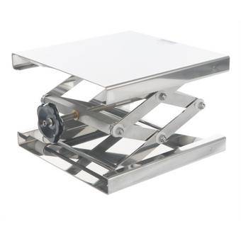

Its modes of vibration look a bit like that:
Stainless steel scissor lab jack with a square platform on top and a square base, raised by a central threaded knob that drives the crossed arms.
This is the closest analogy of a spin-2 wave I know.
