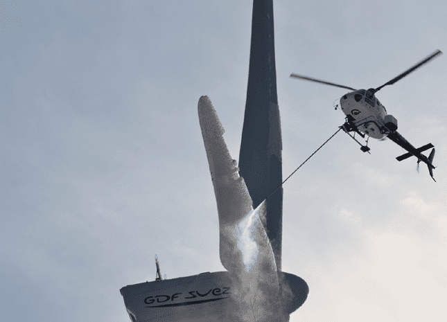

You're trivializing a problem that's more difficult than you think. Studies in many countries have investigated that question and looked at many methods in addition to heating elements. Try this search:
https://duckduckgo.com/?q=wind+turbine+throwing+ice&ia=web
Photo of a helicopter hovering beside a wind turbine tower, with a cable running from it to a large chunk of ice clinging to a turbine blade. The tower base is labelled GDF SUEZ.
Also, consider this:
For safety reasons, the turbines are shut down while the heating elements melt off the ice, Kurt said. That way, there’s no chance of ice flying off spinning blades, potentially damaging the turbines or, worse, striking someone on the ground, she said.
